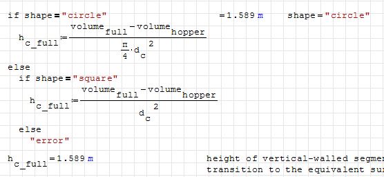

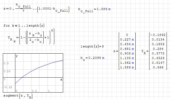

I wish to loop through the YR formula, in pic below, for values of z being 0,0.2,0.4,0.6,0.8,1.0,1.2,1.4,1.589.
My progress so far is to produce an array evenly spaced z values and if the 1.0001 factor is not applied to hc_full then the last element of the z array is 1.362, rather than 1.589.
It is obvious to me that I have some missing skill here, please throw me some hints.
Regards, Tim

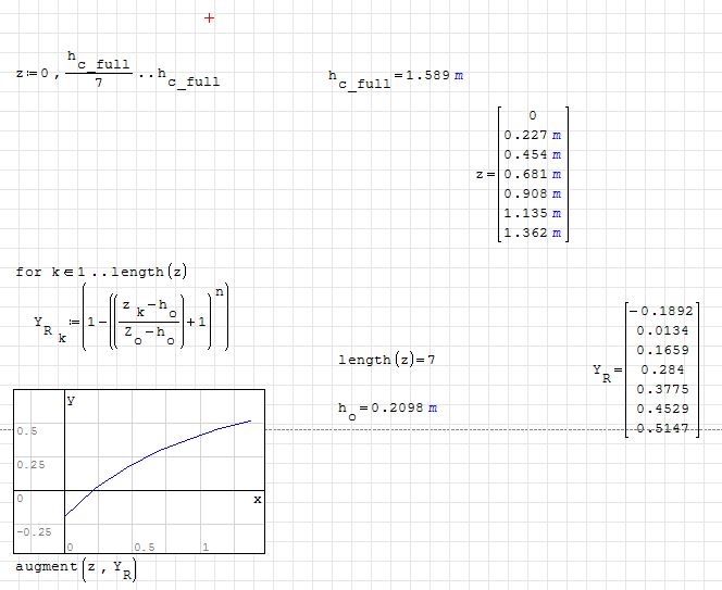

Thank you for typing the work from scratch, and showing no issue with the 1.589 value.
I redefined hc_full immediately above the z range call and then the output changed to match your results.
The hc_full is defined with an if statement.
The 1.589 value is absent from the z range.
The hc_full is redefined directly above the z range call (to override the value produced by the if statement) and the 1.589 value is now present in the z range.
Have I contravened a working principle in some way?

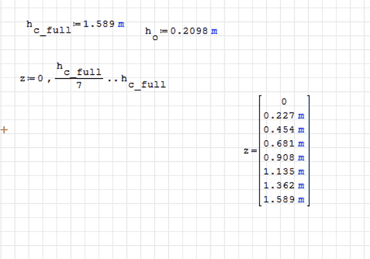

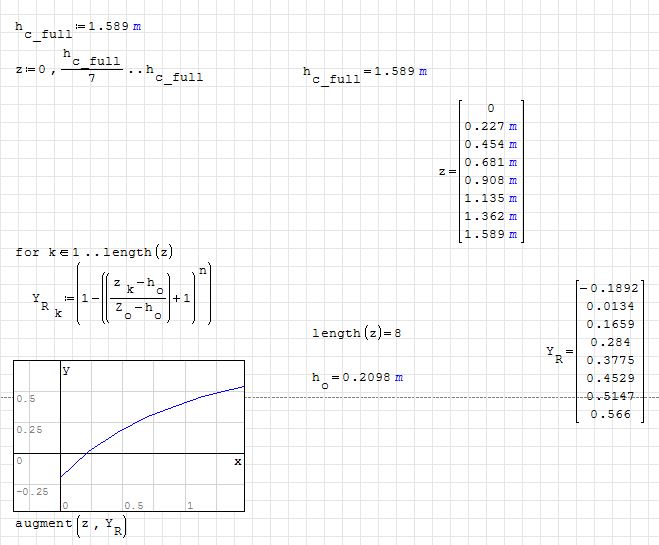

Tim
Redefining hc_full using hc_full:=hc_full also fixes the z range array.

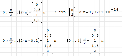

for(3)-loops with initial, second and maximum value aren't robust if floating point values are specified. The internal representation of such numbers may differ from what is displayed due to round-off.
Due to this it is not good programming style to test the equality of two floating point numbers without specifying a tolerance. If you want to be safe, you either introduce such a tolerance or you generate the list of values based on a list of integers.
It should be possible to modify for(3) such that the tolerance is generated as a fraction of the difference between first and second value.
