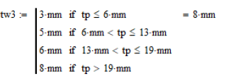

All,
I am new user, need your help how to create this type of equations in Smath

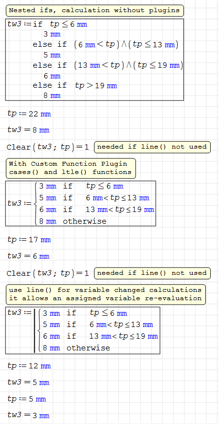

#3 Posted: 2023/6/15 11:42:20
NDTM Amarasekera
NDTM Amarasekera
130 likes in 352 posts.
Based on program by overlord.
if_function_ndtma.sm (27.85 KiB) downloaded 1185 time(s).

#5 Posted: 2023/6/16 06:54:18
... from the drop down fx menu.
#6 Posted: 2023/6/16 10:25:58
598 likes in 1,380 posts.
Making it a function as Amarasekera did is much more sensible solution.
