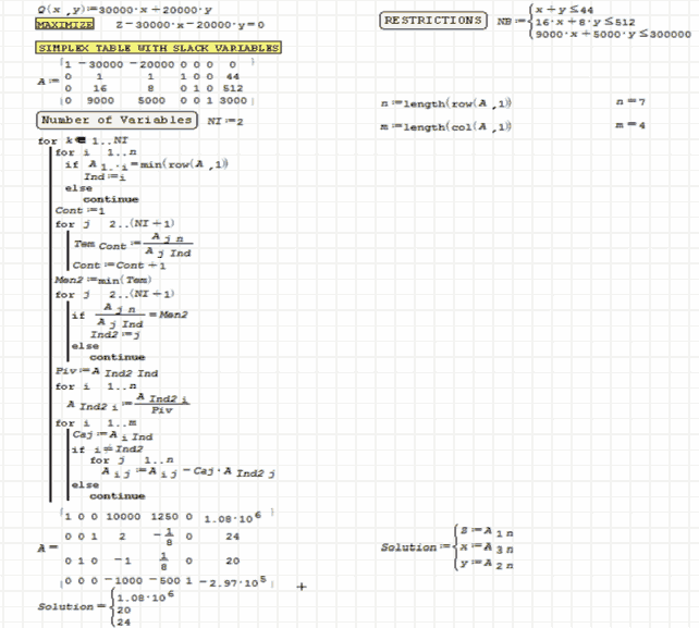

Based on this the author & using an online LP solver I have:
http://prntscr.com/hpk4j5

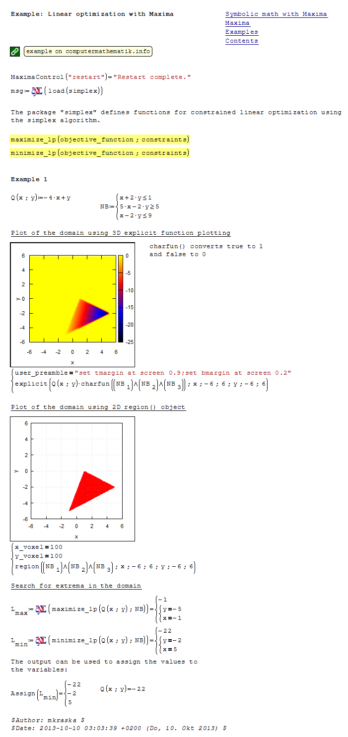

See page Examples> Maxima usage> Linear optimization in the interactive handbook.
Example maxima linear optimization.sm (41.89 KiB) downloaded 1026 time(s).

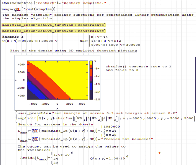

WroteThanks for the answers Jean would you be kind enough to attach the .sm file too.

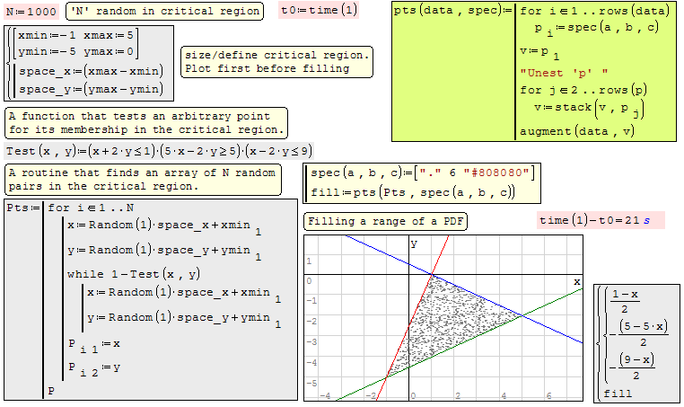

Here is + some extra stuff. Maybe there is way to draw an inscribed 3D ?
Solve GivenFind Critical Region Copy.sm (39.35 KiB) downloaded 1058 time(s).

CAUTION: The algorithm is NOT TESTED, but it works well for this example.
It is necessary to refine it so that it work in all cases.
Small_Simplex_Algorithm_Improved.sm (88.5 KiB) downloaded 1038 time(s).
Carlos
Now it's fixed.
Small_Simplex_Algorithm_Improved_2.sm (135.66 KiB) downloaded 1059 time(s).
Carlos
WroteI'm sorry, I found a bug in the Simplex algorithm.
That huge number in the program, can be replaced by ∞ [Smath machine number]
RemToDo => check vs Mathcad
First A[i ... badly indexed.
Small_Simplex_Algorithm_Improved_2.sm (140.42 KiB) downloaded 1065 time(s).
