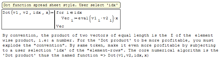

#1 Posted: 2016/8/8 23:49:10
Maths Dot fnct.sm (10.69 KiB) downloaded 1361 time(s).

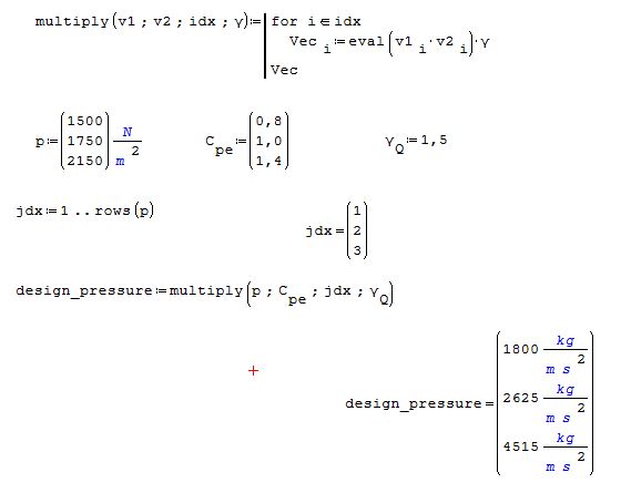

Hello Jean,
Thank you for your sample file!
I can use it very well for my calculations, in which I have different load cases and load factors.
For instance, different net pressures, different form factors for these pressures and a load factor.
See the picture below.
( I have renamed the function for my situation ).
Thanks again!
