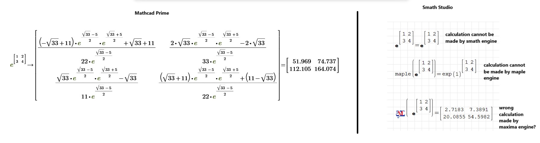

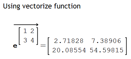

Matrix exponential is not implemented.
You can replicate in SMath what the Maxima engine does with the vecotrize() function (otherwise by default SMath tries to perform a scalar operation and fails).

But still the SMath result is not the same as the Mathcad result...
#5 Posted: 2024/12/25 00:54:48
Cornel
Cornel
2 likes in 78 posts.
I think it's because as Davide said, Matrix exponential is not implemented in SMath. But then how to calculate the Matrix exponential in SMath? There is a way somehow?

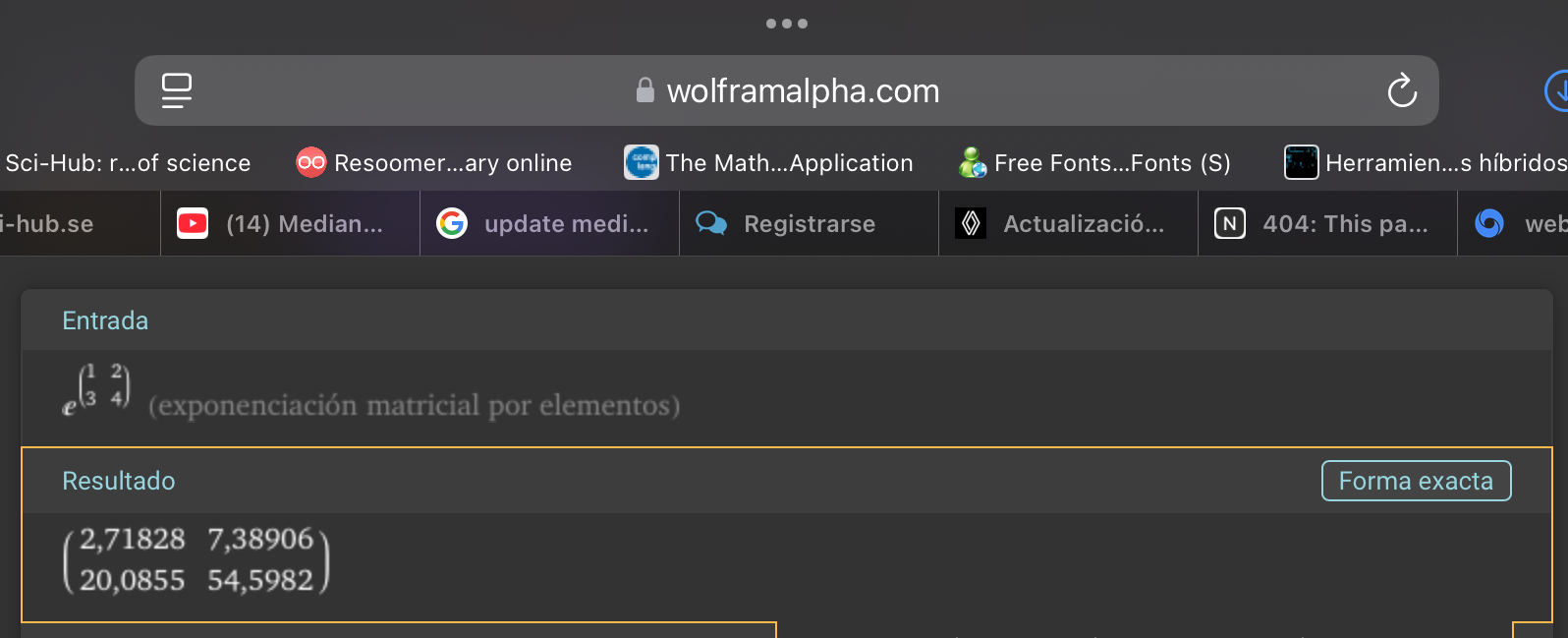

This is the answer via wolfram alpha:
Is the same obtained via vectorize function on SMath. Maybe your file or configuration on Mathcad have some parameters you are not mentioning?
Alvaro 2024/12/25 13:24:00, Davide Carpi 2024/12/25 16:55:00

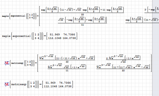

#7 Posted: 2024/12/25 13:29:01
1,123 likes in 1,795 posts.
Hi Cornel. The exponential function is a well-defined function from the complex plane into the complex plane. A possible extension to its domain and range being square matrices analogous to the ordinary exponential function can be defined as e^A = sum(A^k, k=1...infinity). And notice that this is valid only for square matrices, not for the general case.
In general, the other CASs have special functions for this extension of the exponential function: expm in matlab, MatrixExp in wolfram mathematica, exponential in maple and matrixexp in maxima, which you can access from SMath:
mat-exp.sm (13.45 KiB) downloaded 1469 time(s).
So I guess if it is right for the developers of maxima, maple, mathematica and matlab to distinguish between both functions and to have specific instructions for each of them, then doing so in SMath is right, regardless of what the developers of mathcad think.
Oscar Campo 2024/12/25 16:13:00, francesco rapuano 2024/12/25 16:47:00
