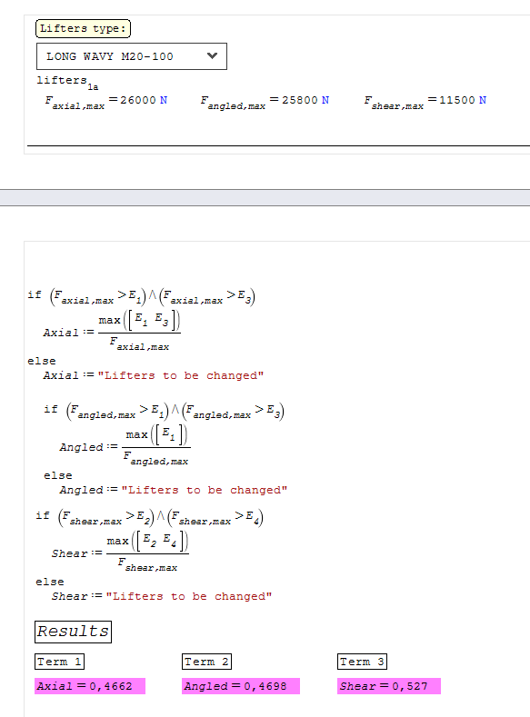

I am new in sMath topic. Can anybody tell me why here my combobox doesn't work correctly? It doesn't download values from rows.
Thanks!

I have identified two errors:
1) you must assign a variable to the combobox
2) seems to have disabled the evaluation of the combobox
Sergio,
can you send me a correct file if it's not a problem?
I now what you mean but that will be the easiest way for me. I still have something incorrect.
Thanks for help

this
Lifterscheck.sm (21.4 KiB) downloaded 1090 time(s).
