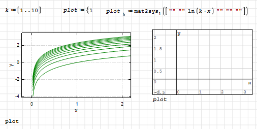

When a parametric function is stacked with sys() nested matrix or matrices, it doesn't plot.
It is plotting if they are at same level in sys(), plot1 example.
When there is no parametric function, there is no problem, plot3 example.
Otherwise 2D plot is not capable to execute.
XY-Plot has no issues at all.
plotbug.sm (23.75 KiB) downloaded 973 time(s).

Once in general the plot regions (built-in, X-Y Plot) can handle nested lists, it is fair to call the failure to do so in special cases a bug
