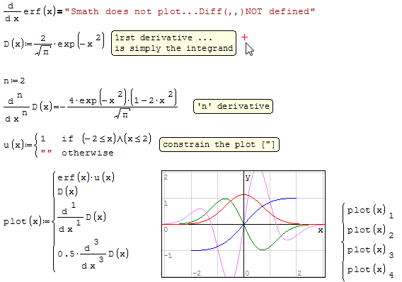

An attemp to use Leibnitz differential notation.
differentials.sm (53.37 KiB) downloaded 1234 time(s).
differentials.pdf (93.64 KiB) downloaded 782 time(s).

#4 Posted: 2019/12/5 14:33:17
Maybe there are more reluctant functions ?
