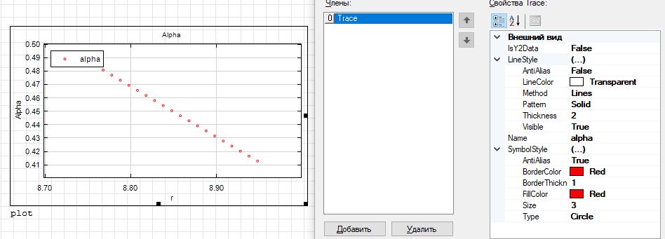

Hi Reg. In addition to Gerry's observation, by double clicking on the XYPlot, in the "traces" menu, "Visible" is set to "False". The "Visible" property must be set to "True". I don't know how to configure the graph to only show shapes without the line that joins them, without modifying the argument with augment( alpha , "o" ) or something similar.
#4 Posted: 2024/9/24 03:22:02
1,554 likes in 1,864 posts.
You can use transparent color for the line.

At 81, I am clearly losing my mind, or my eyesight...maybe both.
Attached is a pdf of my updated file. All is working now, thanks to you.
