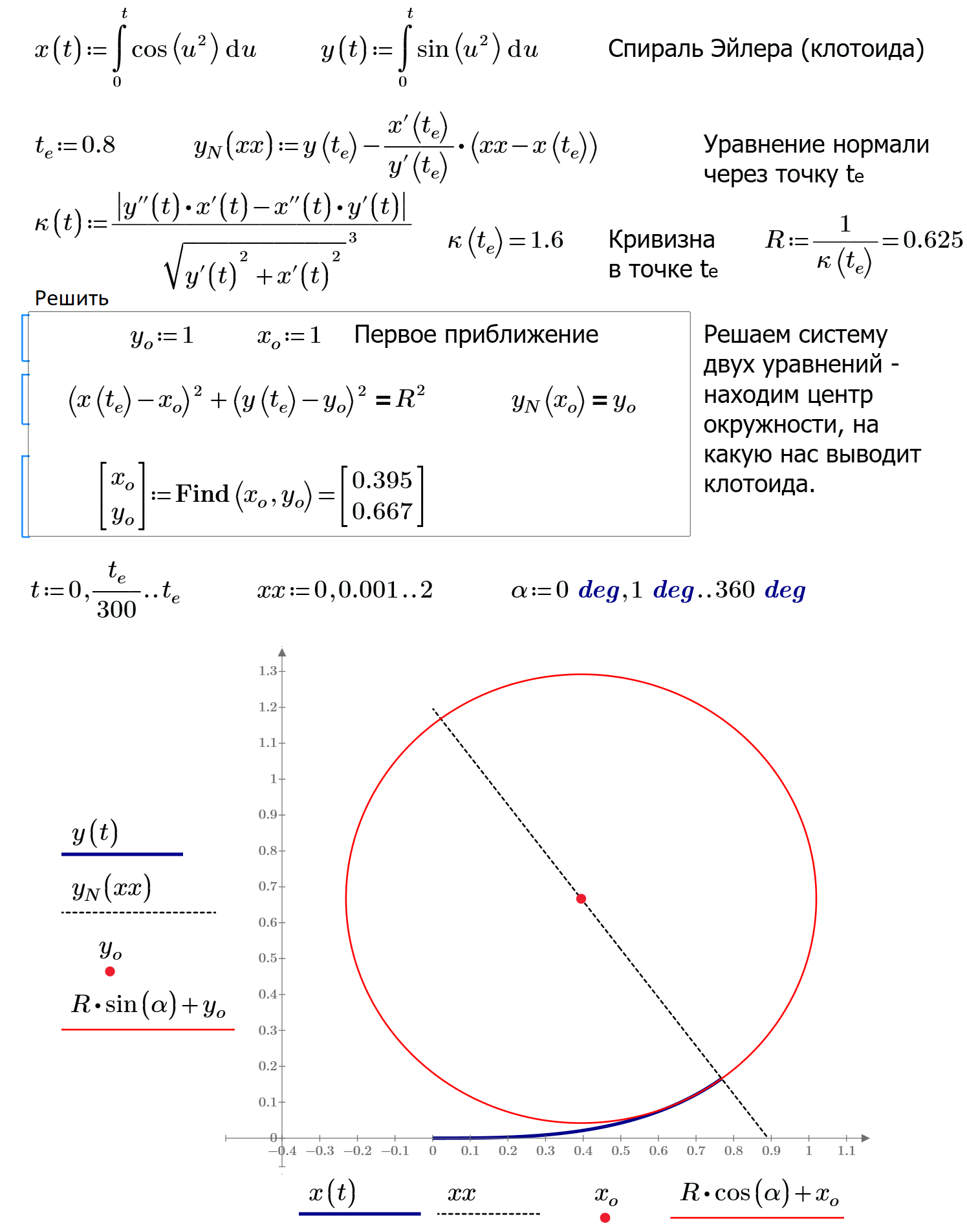

#1 Posted: 2025/5/17 18:08:25
Valery Ochkov
Valery Ochkov
64 likes in 670 posts.
How can I do it in SMath
Edited 2025/5/17 19:14:32

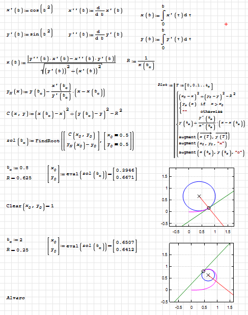

#2 Posted: 2025/5/19 04:34:18
1,078 likes in 1,749 posts.
Hi Valery. This could be a way.
Euler-Spiral.sm (23.92 KiB) downloaded 927 time(s).
Edited 2025/5/19 06:48:22
7 users liked this post
NDTM Amarasekera 2025/5/19 14:25:12, overlord 2025/5/22 13:37:39, Andrey Ivashov 2025/5/19 21:18:07, sergio 2025/5/19 08:17:44, ioan92 2025/5/20 07:37:23, francesco rapuano 2025/5/19 10:31:40, Davide Carpi 2025/5/22 06:34:13
#3 Posted: 2025/5/22 03:48:34
Animating.
Euler-Spiral Forum.sm (33.9 KiB) downloaded 899 time(s).
