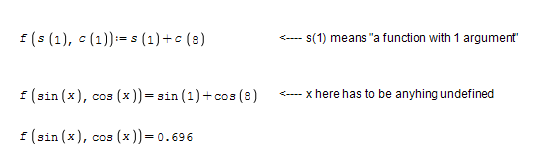

#2 Posted: 2021/7/7 08:32:56
1,435 likes in 2,913 posts.
Yes it is possible, see the attached image

#3 Posted: 2021/7/7 09:31:23
Paweł Wierzba
Paweł Wierzba
0 likes in 6 posts.
Thank you very much. Indeed, it works, even with functions with more arguments than one.

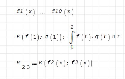

#5 Posted: 2021/7/7 10:11:06
Paweł Wierzba
Paweł Wierzba
0 likes in 6 posts.
Thank you for the advice. Fortunately, standard way of defining functions is well known to me.
Unfortunately, I had to pass functions as arguments, rather than define them the "standard way".
I had several functions and some coefficients to be calculated, based on them.
Something like the example below.
If done the standard way, it would involve a LOT of writing.

#10 Posted: 2021/7/7 15:22:21
1,078 likes in 1,749 posts.
Hi. You can try a for loop with something like this in the body

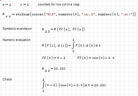

#12 Posted: 2021/7/7 18:02:38

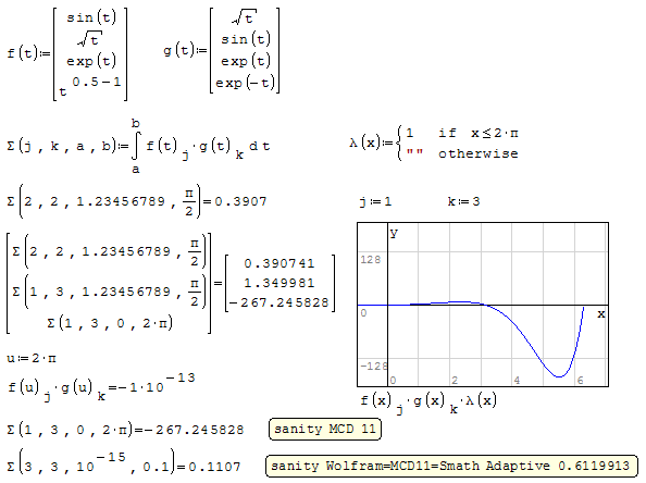

#16 Posted: 2021/7/8 09:45:19
Thank you for help, especially the comment about potential problems
with the integrator and illustrative examples.
I posted the wrong image ... that's the right one.
Don't drop dead by how far simple integration can fly in the blue !

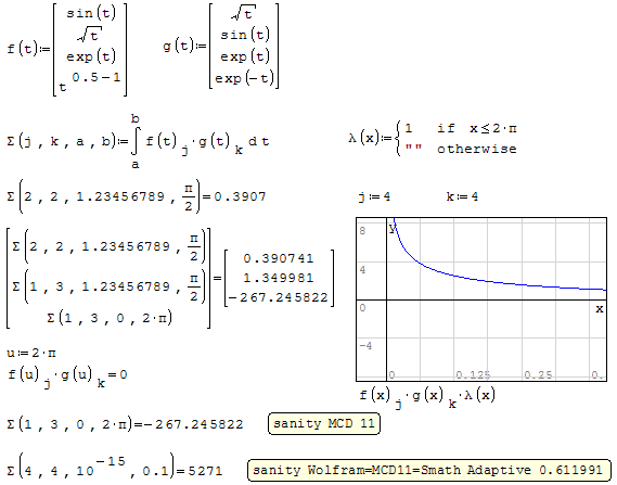

#17 Posted: 2021/7/8 14:44:44
Thank you for help, especially the comment about potential problems with the integrator and illustrative examples.
The 'thanks' button' never worked.
1. The previous image as *,sm
2. My Integration tool box.
Please, don't hesitate for + ... Jean

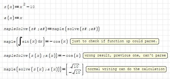

#19 Posted: 2021/7/8 17:21:01
Looks like line() mysteriously solve the issue.
Hi. For help understanding what's happen: that behavior is similar to the SetDelayed in Wolfram Mathematica language: https://www.wolfram.com/language/elementary-introduction/2nd-ed/39-immediate-and-delayed-values.html
