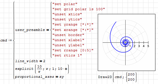

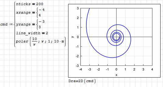

This is how it can be done using Maxima. Full flexibility is gained using direct gnuplot commands.
Draw2D3D-EN.sm (1017.89 KiB) downloaded 1492 time(s).
SMath with Maxima.pdf (3.5 MiB) downloaded 4097 time(s).
