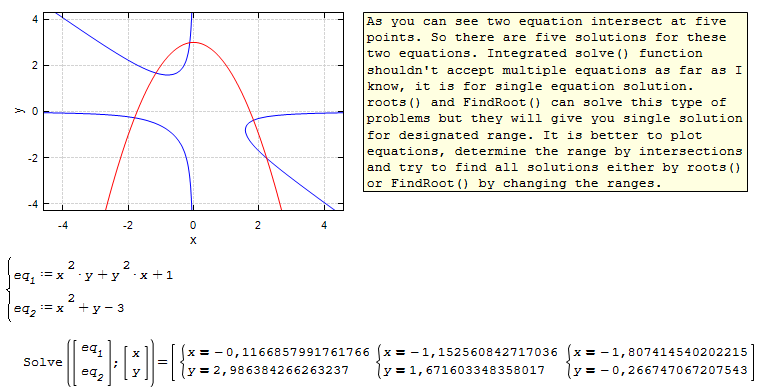

Maxima's solve seems to provide multiple yet not all solutions.
nonlinear_kr.sm (8,26 КиБ) скачан 1056 раз(а).
Tuan Nguyen 20.04.2021 02:19:00
#22 Опубликовано: 19.04.2021 17:02:46

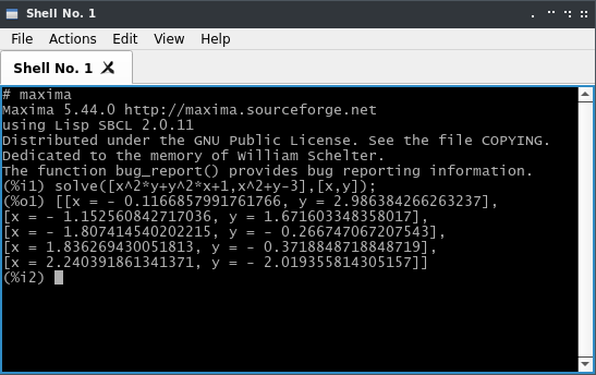

Interesting, cause maxima in linux terminal can find all solutions.
I have tried, wxMaxima (gui of maxima) can also find all of them.
It should be careful if the equations are a bit more complicated.

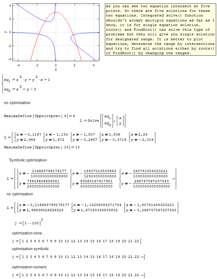

Could you please set optimization to symbolic, expand the matrix, then set to none again?
Maxima may have found all solutions but can't show because of matrix reduced view.
Three dot to expand matrix doesn't appear if optimization is selected to none.
This is a cosmetic bug if I had to make a statement.

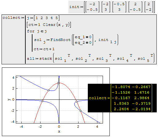

FindRoots is sensible to initial, like any other solvers.
Thus a good practice to let it breath by itself from initial
... then collect from visual sanity plot SS 6179.
You are right, there seems to be a display bug. Thank you for pointing this out.
Optimization None doesn't properly co-operate with result ellipsis mechanism.
The resize handle is missing.
This is bad in two ways. First, you can't change the amount of displayed elements, second, you can't even see that there are suppressed elements.
