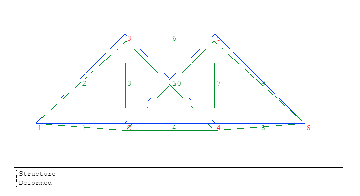

Hi LORENZO,
Here is FEMTRuss, my own version of truss calculus via FEM.
I'll check your work, please you check mine
FEMTruss.sm (49,06 КиБ) скачан 1526 раз(а).

So far results look good. Great work!

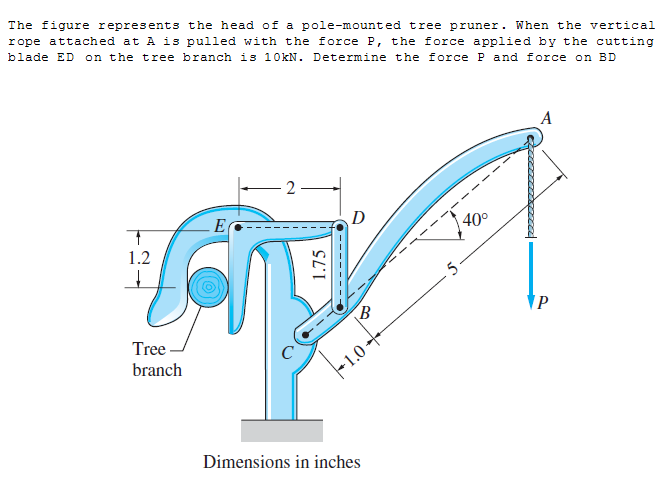

The only thing I understand in there is the construction.
A little example solved by FEM...
P4-118 Pytel modified.sm (165,01 КиБ) скачан 1496 раз(а).
