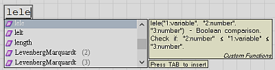

This way also, using lele function. Thank you Jean for the example.
Cheers
