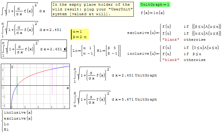

Hello David,
Many Smath users are "pro" using the unit system, not me because unit system
does not pass QA [Quality Assurance]. From a wild result [not unit affected],
you can post-add your own system.
UserUnit.sm (13,41 КиБ) скачан 1188 раз(а).

#4 Опубликовано: 21.05.2017 12:20:13
Smath crashed, Oh !
More collabs will visit to help you rescue your Smath.
Here is the work sheet in compacted image.
Hope it open, no crash ?

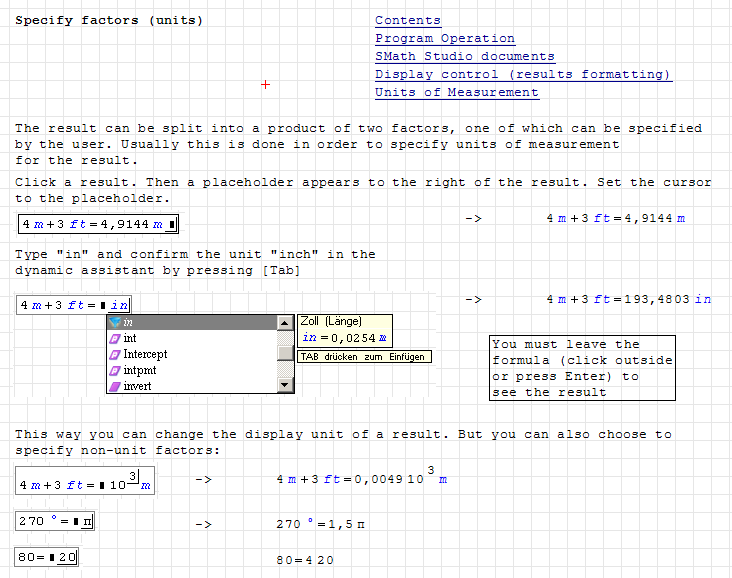

#5 Опубликовано: 21.05.2017 16:33:42
I cannot create this system of units by changing the constant.xml and units.xml sheets because the underlying structure is different. I have also created worksheets with unit definitions that work, but the software wants to produce the results in SI units, which is really messy. I need to have the results in the native units I have devised.
Maybe, it is as easy as typing the unit you want for the result in the square black placeholder?
2017-05-21 21_30_24-SMath Studio 0.98.6179 - [Section operation units.sm].png
Section operation units.sm (21,32 КиБ) скачан 1179 раз(а).

#7 Опубликовано: 21.05.2017 18:18:48
Hello [userlink]aetherwizard[/userlink]
My objective is to have a native units program where I can teach the value of this new units system to others. The program needs to be able to render the results in the new system of units automatically. If I can get access to the code, I can setup the dimensions according to the new units system, as well as the new units, and the output will be correct.
The ability to handle different units' systems is one of the main goals of SMath Studio as well (SS-1); the code thus is designed to be neutral, it simply loads units.xml and use its data to manage the units (any relation is defined in that file, there aren't hardcoded instruction to prefer meter over inches or 1/s over Hertz or whatever else). There are known issue mentioned by Martin (f.e. here) and probably there are more; I guess would be much more profitable for the whole community to try to develop a units.xml file with your units system and try to identify precisely the issues, what should be done but actually can't be done or seems impossible to do (instead of applying hardcoded exceptions for a specific case - this rarely ends up in good things).

That's what I suggested "paste in the rightmost place holder"
paste the unit as written in "Writer region" ...+++ more symbols.
