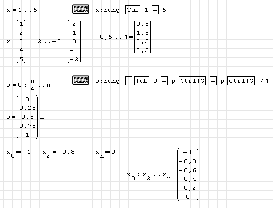

First, thank you.
Second, quick question, in the 'for' statement shown above (for i from 1 to n+1) how do you get the two periods (the "to" part of it)? What keys are pressed?

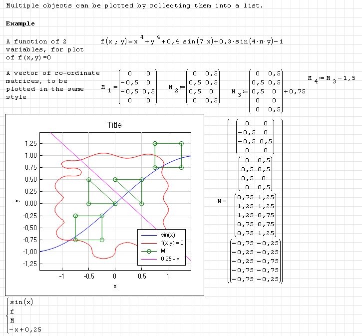

Martin,
I'm taking a look at this again...
I seem to be having an issue getting this to plot.
Interaction - Graph.sm (7,35 КиБ) скачан 1584 раз(а).
What exactly is your issue? As I could see, you just did not change the scale for X-Y plot and therefore did not see your data plotted.
