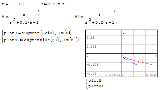

I am a new user of SMath. I mainly use it for control system analysis and drawing Bode plots for transfer functions.
I am trying to figure out how to change the marker for different curves. I use Maxima plugin.
Please see my attached file.
ThanksTF.sm (53 КиБ) скачан 1335 раз(а).

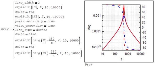

Thanks for your reply.
What I was trying to figure out is how to change the marker point for curves for better visualization. I could find out how to changes the line width and color in Maxima as you can see in my file.
It is easy to do it with X-Y plot but I needed log scale and it is available in Maxima.
#4 Опубликовано: 23.12.2021 21:52:06
Hi. Use line_type≡dashes. Other types are dots, short_dashes, short_long_dashes, short_short_long_dashes and dot_dash

#5 Опубликовано: 24.12.2021 00:40:56
PE_Electron
PE_Electron
Thanks so much. This is helpful.
