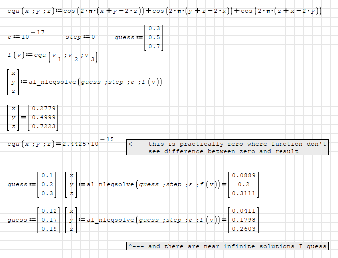

More experienced users may help you better than me.
But your equation seems to have infinite solutions.
al_nleqsolve equ(x,y,z).sm (10,75 КиБ) скачан 1211 раз(а).

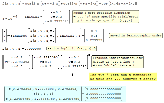

As overlord points, there are infinite solutions. Just like the better visual representation for z = f(x,y) is a surface in the 3D space, w = f(x,y,z) is a hypersurface in the 4D space. But we can't see that plot. So, here a plot of families of that 4D hypersurface, like a contour plot, but with surfaces.
About Dragilev method, I can't find my setup for 3D, and the expert there is Viacheslav (uni).
Plots4D.sm (111,28 КиБ) скачан 1282 раз(а).
Plots4D.pdf (393,96 КиБ) скачан 862 раз(а).
