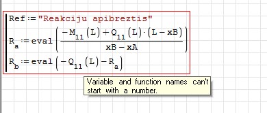

#20 Опубликовано: 11.02.2021 03:32:36
Egidijus
Egidijus
Hello, could somebody help me. I don't understand how to solwe this problem.
