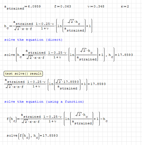

I attach here the SMath solution for your question.
best regards,
w3b5urf3r

Excellent, thanks w3b5urf3r! That answer is close to what I was looking for!
This program looks very simple to use.

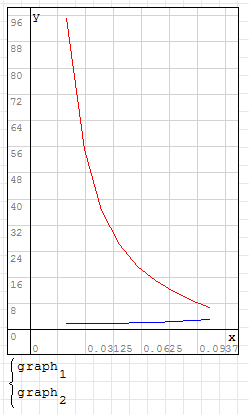

: In the above example, I assumed that hc is not a function of any other additional variable. What if, in the same equation, variable f is a function of x (like f=2x, where x range from 0 to 1 (0, 0.1, 0.2, 0.3..1). Can we then plot hc as a function of x on a graph using SMath?
Thank you for your help and please only suggest answer to my question if it does not take too much of your time. I truly appreciate your help and time.

You can do it in different ways; in the attached example I define a vector of x values (using the range() function) and then I've solved an equation for each x value with a loop and then I create the matrix to plot. Obviously if you know very well the output behavior you can do all the operations "on the fly", inside the loop.
regards,
w3b5urf3r
