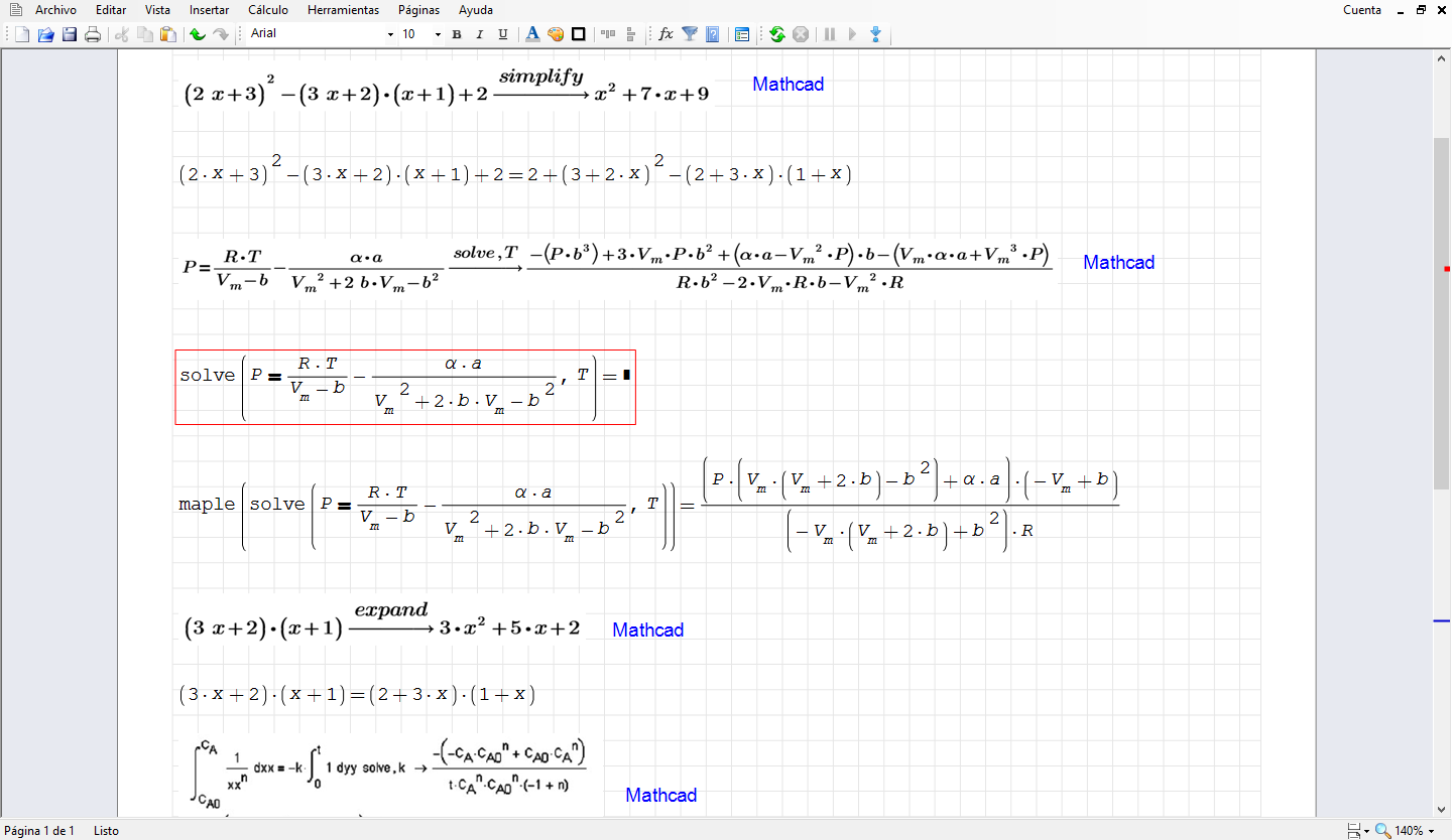

#3 Опубликовано: 31.08.2021 19:34:42
Hi Valentino. This is a way.
Mathcad to SMath Studio.sm (102,93 КиБ) скачан 1439 раз(а).

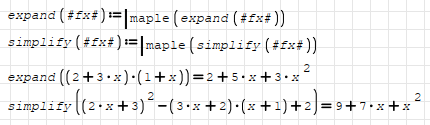

#8 Опубликовано: 01.09.2021 19:01:18
You can write your own functions to make expand(),simplify() work as if they are implemented.
Don't sure if they will work with complicated function, but they are fine with simple ones.

Alvaro thank you very much, your solution has worked very well for me. I have a question, you use commands like "Collect" and "Opt" but they don't appear in "all my functions"; The program executes the commands but it does not allow me to see their description or know what they are for, are they from a complement?

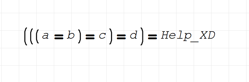

How did you put so many "boolean equals" without the parentheses being uncertain?
¿Cómo pusiste tantos "iguales booleanos" sin que los paréntesis sean inciertos?
Thank you
#12 Опубликовано: 01.09.2021 20:59:49
From an old Mathcad/Mathsoft contest.

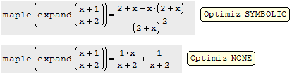

Opt = Symbolic or Opt = None means that you must to right click over an expression, and choose Optimization / Symbolic or None, not a command.
With some hard work you can hack the SMath syntax: From https://en.smath.com/forum/yaf_postsm56111_Some-future-requests.aspx#post56111
HackingEqual.sm (3,3 КиБ) скачан 1881 раз(а).

#20 Опубликовано: 02.09.2021 11:24:40
With some hard work you can hack the SMath syntax.
This is nice. I didn't know it could be done.
Formulas work even after brackets removed.
Not just a cosmetic removal.
Thanks a lot.
