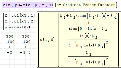

4. Max/Min value in matrix/vector
5. max/min of vector function(s) [example attached]

#4 Опубликовано: 22.06.2018 00:00:42
Cursor needs to work like mathcad
Do you have that in Mathcad ... hover the pointer on the function.
#5 Опубликовано: 22.06.2018 00:03:50
... forgot to attach the document.
Genfit [HV_WEZ].sm (39,66 КиБ) скачан 1520 раз(а).

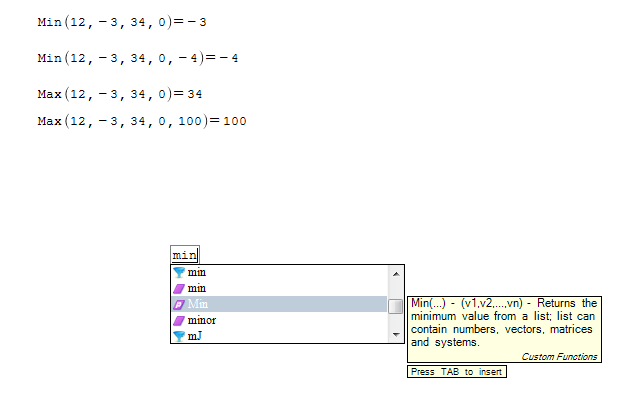

Mathcad Prime != MathCAD != SMath. If I recall correctly PTC didn't even have a great way to convert between MathCAD and MathCAD Prime. I know there existed a converter tool, but I had sporadic luck with it. This really isn't feasible between SMath and Mathcad or SMath and Mathcad prime. It best to manually convert.
Min() and max() functions ought be overloaded to also accept multiple arguments (same functionality as Mathcad). Or provide an easy way to convert the old mathcad files.
If you install the custom functions plugin, it includes functions that do this.
Cursor position / selection interface is not intuitive / cumbersome / buggy. Cursor needs to work like mathcad, not jump around semi-randomly.
Not sure what problems you've encountered with this. Do you have specific suggestions? Again, SMath != MathCAD. The interfaces you mention in SMath I have become familiar with (being a Mathcad convert myself) and now find MathCAD UX clumsy. It's just a different program.
I understand Smath is free and I'm in no position to make demands. But I hope the software is successful and including above in your planned development should help a lot.
I love the quick response from developers to improvements and input from the users. There is a great community in this forum if you have questions on implementations as well.
Example of Min/Max functions:
