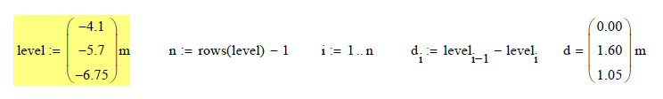

Does anyone know how to use vectors with subscripts (by typing: [) in SMAth as I have done in the attached Mathcad file (.pdf + .xmcd). I have tried it in SMath (see the attached SMath file) but this does not work in the same way. Does anyone knows a workaround?

Hello Rens,
You can do it in the same way, but indices here are base 1 instead of base 0
SMath file (r1).sm (4,53 КиБ) скачан 1206 раз(а).

Thanks a lot Davide!
