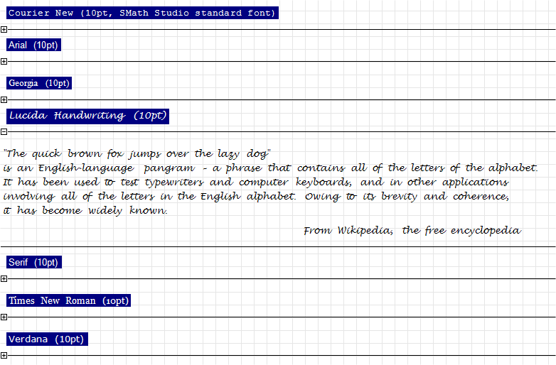

#12 Опубликовано: 18.02.2013 17:51:11
A sheet containing some text area with various font-families to use in your own scripts (copy from this sheet, paste in your sheets and modify the area).
best regards,
w3b5urf3r
ioan92 01.03.2014 16:06:00
#13 Опубликовано: 01.03.2014 11:55:30
Uploaded in the Extensions Manager (Examples)
Best regards,
Davide

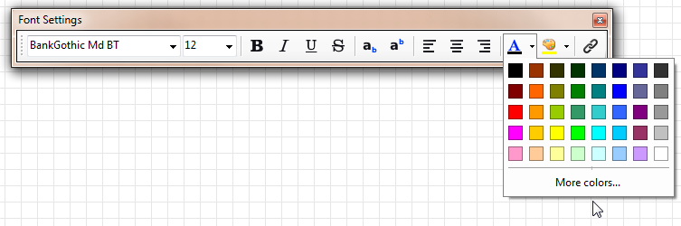

#17 Опубликовано: 26.09.2014 13:54:17
Any chance a donation of some size could get us a toolbar that would allow us to easily change to these fonts?
Trust me, the toolbar is the minor of the issues
BTW working to the SectionRegions plugin, I'm making an easy-to-use WriterRegion, and I've also produced a (back-end) customizable toolstrip to drive the text settings (as for now, the toolbar is just a toy).
ioan92 26.09.2014 14:17:00

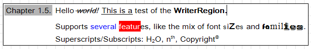

#18 Опубликовано: 08.10.2014 12:37:01
A screenshot... will be relased as WriterRegion (when will be stable and complete enough).
6 пользователям понравился этот пост
hitaisin 04.01.2015 04:37:00, Radovan Omorjan 08.10.2014 13:54:00, Вячеслав Мезенцев 08.10.2014 13:12:00, ioan92 08.10.2014 15:28:00, Peter 09.10.2014 00:07:00, Andrey Ivashov 11.10.2014 09:11:00
