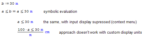

#3 Опубликовано: 23.01.2021 05:56:50
it's just a cosmetic solution
disuguaglianze.sm (5,31 КиБ) скачан 1169 раз(а).

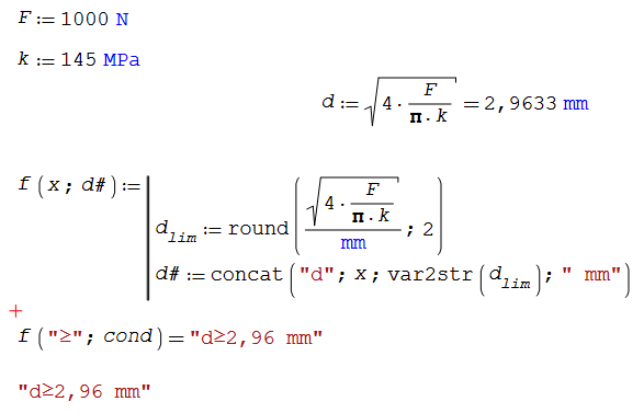

#4 Опубликовано: 23.01.2021 11:14:58
A very limited native solution
Blatt2.sm (4,65 КиБ) скачан 1218 раз(а).
