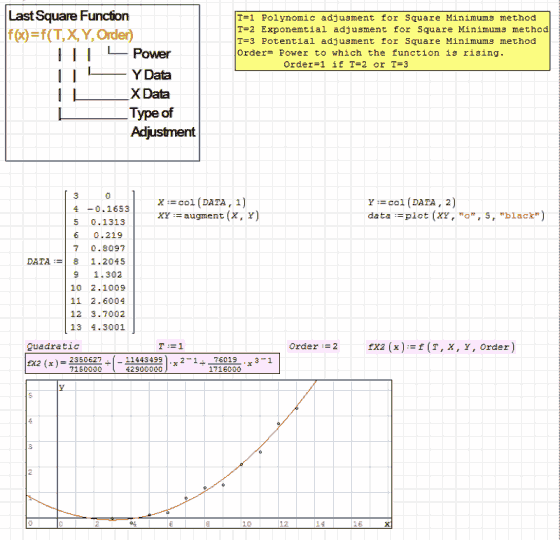

#1 Опубликовано: 26.04.2019 00:06:13
CBG
CBG
Another example of curve fitting by the least squares method
with option to select the power of the polynomial, or
select the adjustment of the curve to exponential or potential.
Ajust_by_Last_Square_Selection_Jean.sm (56,61 КиБ) скачан 1284 раз(а).

#2 Опубликовано: 26.04.2019 10:40:32
Hola Carlos !
Couldn't open the attached SS 7030 work sheet.
It happened another time from maybe Alvaro ?
Seemingly caused by 2 of your modules not activated.
My SS 6179 does not closed those two particular modules.
However, I have recognized the flat parabola data set.
I'm sure your proposal will have more applications.
Data sets with flat region best fit by model function,
like this one from al_nleqsolve, always assumed noisy.
Two flat parabolas attached
Thanks... Cheers ... Jean
Genfit [Algo Minimize(Cholesky_3 NonLinear)].sm (37,14 КиБ) скачан 1014 раз(а).
Genfit al_ nleqsolve [Edu Model FLAT Parabola].sm (30,24 КиБ) скачан 1001 раз(а).
#3 Опубликовано: 26.04.2019 14:18:39
CBG
CBG
Hola Carlos !
Hola Jean
Here you have a version in 6179 of the work sheet
of the method of adjustment of curves by least squares
Ajust_by_Last_Square_Selection_Jean_V6179.sm (52,77 КиБ) скачан 1303 раз(а).
Cheers
Carlos
