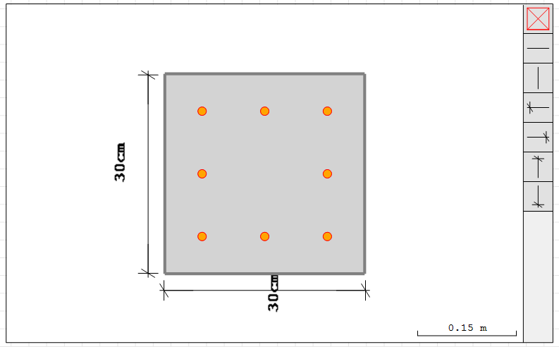

Hi, I want to set my label to vertical dimension but when I rotate the text it gets distorted, please how can I fix it?

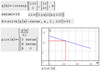

I made a sample with two different plots.
You can use them by changing variables.

#4 Опубликовано: 26.02.2023 17:33:26
TwoPointsPlot.sm (11,84 КиБ) скачан 1335 раз(а).

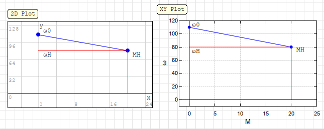

You can also use line and polyline commands for plot.
They work only in XYPlot, but sometimes they make everything easy.
There is also a setprop() function.
It can change format of your XYPlot automatically.
Search setprop() in forum for further information.
DPT_NV plot.sm (20,47 КиБ) скачан 1514 раз(а).

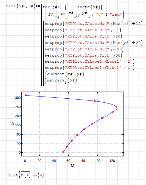

One more question:
if I have a graph (attached file), then how do I mark the points along which it passes?
I tried: vector M(s) ω(s) "." 15 "blue"
but the application immediately crashes.
AD.sm (20,17 КиБ) скачан 1309 раз(а).

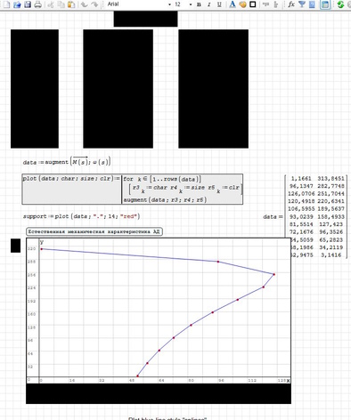

#8 Опубликовано: 27.02.2023 08:47:08
If I have a graph (attached file), then how do I mark the points along which it passes?
As in the attached.
Instead of re-scaling the same graph, plots all new graph on the same plot.
You will scale to accommodate for the larger graph.
AD Plot Points.sm (104,39 КиБ) скачан 1388 раз(а).

#10 Опубликовано: 27.02.2023 13:38:10
Is there any simple way to add the pass points and autoscale a graph?
Some Smath versions decided that opening in other versions will be black.
1. Open this document
2. If black, select by groups, click on background white
3. Make the all document as per 2. directive
4. at this point, you have recovered my original
5. Plot points and more advanced.
AD Plot Points TopUser2000.sm (87,24 КиБ) скачан 1323 раз(а).

You can use this, XYPlot region is suitable.
One custom function to plot everything.
It also autoscale the graph.
AD.sm (28,23 КиБ) скачан 1286 раз(а).
