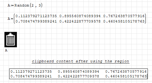

#1 Опубликовано: 26.09.2013 20:32:23
SMath up to 0.96.4909 > password: test
SMath 0.97.5301 or later >
link a variable in the placeholder and left-click on the region to export the variable to the clipboard (clipboard's content can be pasted in spreadsheets or text editors - can't be used as variable in SMath)
Also, you can paste spreadsheets data directly in the region placeholder.
PLEASE REPORT HERE ANY ISSUE
Best regards,
Davide

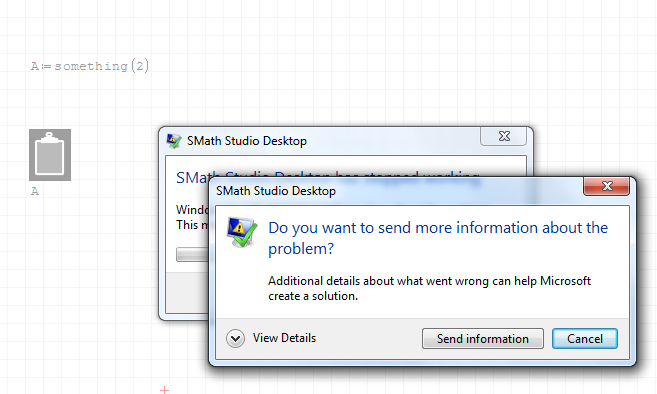

#3 Опубликовано: 27.09.2013 12:13:04
Thanks Davide
Try to reproduce this one
A:=something(2)
where something() is not defined. This will crash Smath for me.
Davide Carpi 28.09.2013 10:18:00
#4 Опубликовано: 27.09.2013 12:22:55
Thank you both, I'll check the issue

#5 Опубликовано: 28.09.2013 10:17:25
Thanks Davide
A:=something(2)
fixed & updated

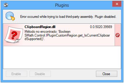

#7 Опубликовано: 10.03.2014 03:30:22
experimentator
experimentator
1 сообщений из 21 понравились пользователям.
After installing the ClipboardRagion pluging Smath displays the error as follows.
I have neither the possibility of deleting nor re-installing.
Learning by doing
#8 Опубликовано: 10.03.2014 03:59:22
Just search for the dll and remove the associated folder structure, typically "some cryptic name/some version number". Currently that is the only way to remove plugins.

#9 Опубликовано: 10.03.2014 04:24:30
experimentator
experimentator
Danke Martin, it works, but I cannot install the extension again, occurs the same problem.
Learning by doing
#10 Опубликовано: 10.03.2014 04:45:58
That's because the Clipboard Region plugin has not yet been updated to SMath Studio 0.97 (there were API changes). Also there might be problems in actually doing the update (Davide reported problems with clipboard handling).
Davide Carpi 10.03.2014 06:41:00
#11 Опубликовано: 10.03.2014 06:45:02
Exactly, as for now this plugin works only with SMath up to 0.96.4909; a new plugin will be relased when Andrey will fix the issues in the clipboard interface.

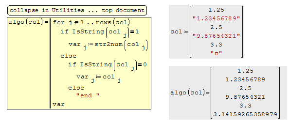

Reiltar
Reiltar
Hi all,
First of all, sorry for reopening such an old topic but.... hasn't anybody had an issue then trying to import to smath negative values from excel?
Maybe it's related with revision changes in both smath and excel, but when I have negative values I get them imported as text, between quotes "-0.534" i.e
any idea about how to solve that?
Thanks,
#15 Опубликовано: 29.08.2022 13:18:42
I'll check it, thank you for reporting the issue.
sergio 29.08.2022 15:57:00
#16 Опубликовано: 29.08.2022 15:01:06
"-0.534" i.e
In the mean time it will doctored otherwise.

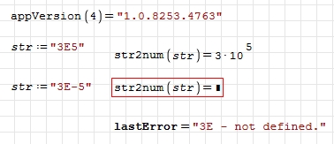

#17 Опубликовано: 29.08.2022 15:36:19
1 138 сообщений из 1 805 понравились пользователям.
Hi Davide. Related, though not exactly a plugin question. But since you are going to see the question of the sign in strings, do you know how to specify a negative exponent inside SMath, as in the following example?
Thanks in advance.
sergio 29.08.2022 15:57:00, churichuro 29.08.2022 20:02:00
#18 Опубликовано: 29.08.2022 20:01:31
churichuro
churichuro
29 сообщений из 79 понравились пользователям.
Alvaro an alternative way is
while a better solution is given.
sergio 30.08.2022 06:19:00, Alvaro 30.08.2022 00:32:00
#19 Опубликовано: 30.08.2022 00:36:17
Hi Churichurro. Thanks, it is a very good workaround, it works, substituting str2num(strrep(STR,"E-","*10^-" ) )
#20 Опубликовано: 01.09.2022 09:25:12
Reiltar
Reiltar
"-0.534" i.e
Thanks for this temporary solution.
