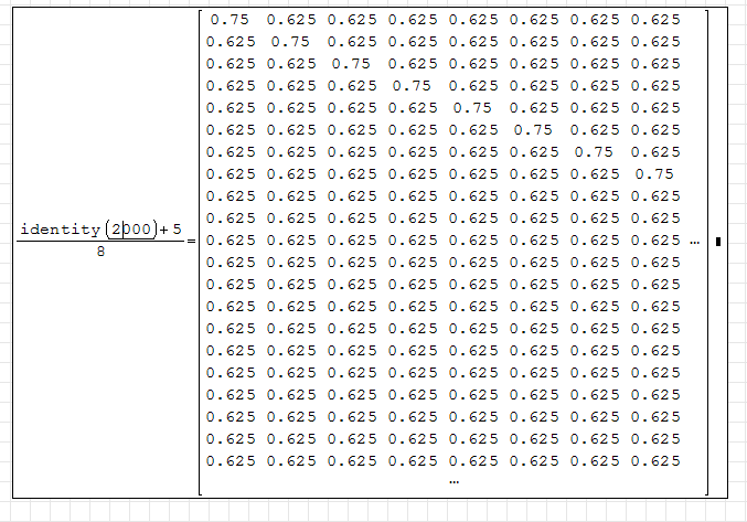

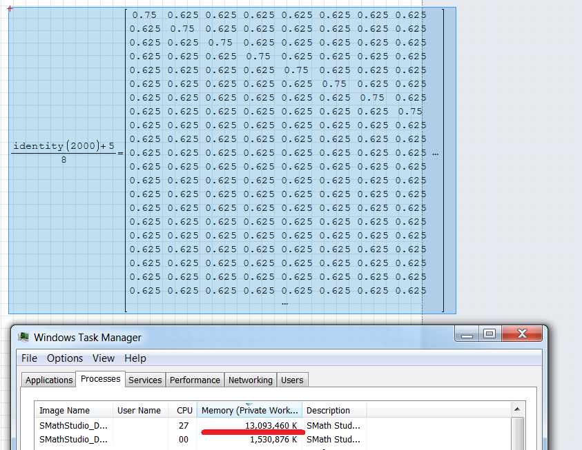

I very much enjoy the encreased computation and GUI performance.
Here is a peculiarity I have found in the recent release:
If I click on the matrix defining expression there is a lag. There is even larger lag when I position the cursor right after "2" in "2000" and hit backspace. In fact it seems (based on the duration of the lag) that expression is fully recalculated when I hit that backspace button - I would think it is not the intent.
Also the resulting size of the uncompressed .SM file (sreenshot attached) is 141 MB (it might have always been this large for large matricies). When I try to copy/paste the expression from attached workbook to a blank one, the destination SMath hangs and is not responsive for good 5 minutes now.
Overall though, those are minor hiccups for the performance boost we ar getting with the 0.98 SMath Studio. Thank you very much
P.S.: one day we will be able to define & manipulate 5000 x 5000 matricies quickly and with ease

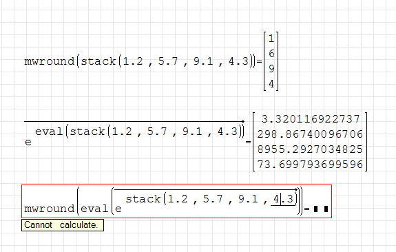

Hello Andrey,
Today found strange error with mwround() function.
Seems to be working in 5928.
#9 Опубликовано: 29.03.2016 22:33:25
Mike Kaganski
Mike Kaganski
I haven't Matlab C++ Math Library; however, other functions work similarily. And your example looks strange (eval() inconsistently positioned).
This works for me (using Diag() as mwround() replacement):
Here is the cause of your error:
Seeems that without eval(), the vectorize() treats output from other functions (stack in this case) as scalar (it doesn't see the array here before function evaluation - you didn't pass one explicitly), and thus ultimately simply passes its result (that happens to be vector) to the exponent.

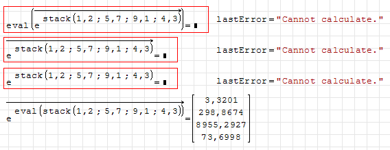

#10 Опубликовано: 30.03.2016 01:11:44
Hello Andrey,
Nothing strange. What you construct right Smath concludes right.
Otherwise, you gave many wrong instructions "Can't calculate"
Just watch on what you plug the vectorise operator. You may have
to put some stuff within brackets.

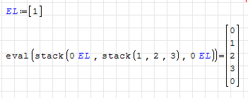

stack(0,v,0) - doesn't work (Mathcad style). Now you have to use eval(stack(stack(0),v,stack(0))) to be sure.
You can use units for this:
Davide Carpi 31.03.2016 14:23:00
#14 Опубликовано: 31.03.2016 10:04:04
Davide Carpi 31.03.2016 14:15:00
#15 Опубликовано: 31.03.2016 14:20:00
Interesting; using the same approach:
The Jean solution is elegant too.
But in the end I'd prefer the built-in way; note that the issue is related only to the first element in stack (in augment too) -> imho if the first argument of these functions is a number should be considered like a 1x1 matrix (meaning that the desired output will be a column vector or a row vector; at first glance I don't see drawbacks);
