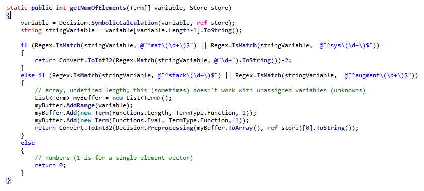

You can try to use/enhance the IsScalar() and IsMatrix() functions of varManager snippet (updated to fix an issue in IsArray(#)).
EDIT: If you are writing a plugin you can use something like the getNumOfElements function in StatisticalTools or NonlinearSolvers plugins

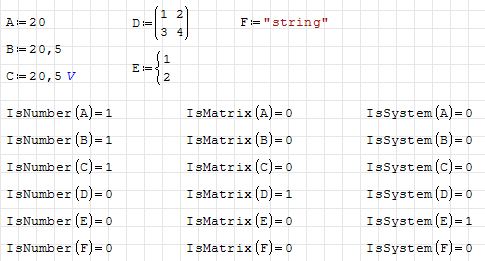

Just as a feedback the IsNumber fails evaluating infinity and imaginary unit and there are some issues with single elements arrays/systems

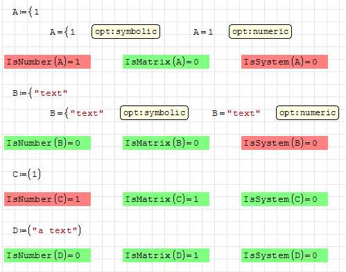

There still remain some other issues in your snippet (see the snapshot)
