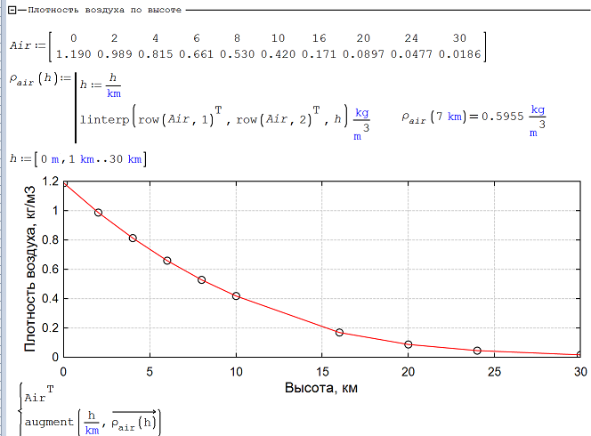

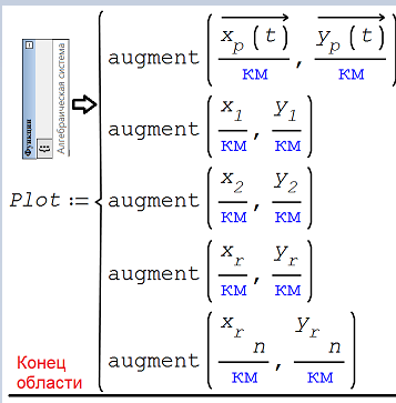

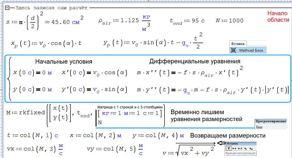

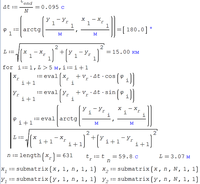

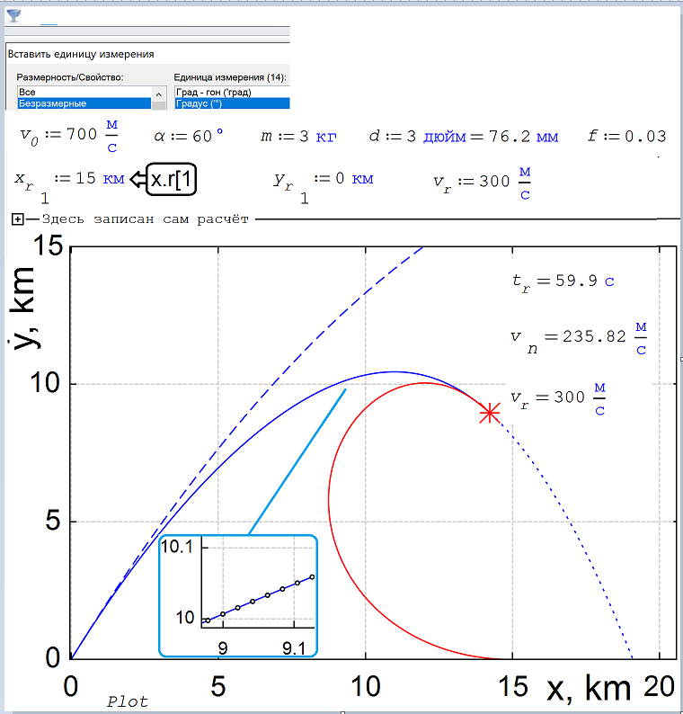

With air resistance
The article (Russian) Iron-Dome.pdf (642,75 КиБ) скачан 1405 раз(а).
SMath-file IronDome-Air-h.sm (47,53 КиБ) скачан 1764 раз(а).
