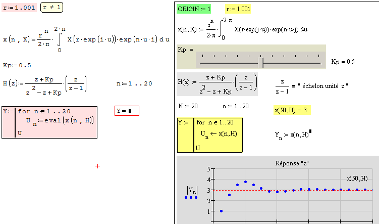

Can't manage this otherwise than shitting bricks !
Solution is welcomed ... Thanks
Done otherwise to rescue the Document.
Inst_PID Discrete Schema EXAMPLE_6 Failed.sm (36,61 КиБ) скачан 1264 раз(а).

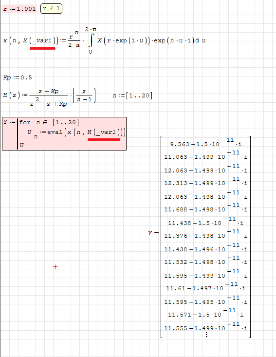

In order to pass functions as inputs to other functions you need to declare it as such and pass a "dummy" variable. See following.
There is still a problem in that it is not evaluating properly, I believe.
Inst_PID Discrete Schema EXAMPLE_6_Partlyfixed..sm (44,75 КиБ) скачан 1253 раз(а).

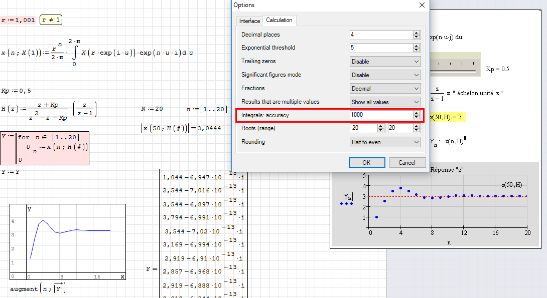

fixed
Inst_PID Discrete Schema EXAMPLE_6 - fixed.sm (46,19 КиБ) скачан 1286 раз(а).
2018-12-11 00_34_33-SMath Studio - [Inst_PID Discrete Schema EXAMPLE_6 - fixed.sm].png
  • removed answer requested for first argument of the last system;
  • used f(number_of_arguments) function of function argument (more elegant, point out that the variable name doesn't matter);
P.S. To obtain similar results, change the integration accuracy to something higher than 100
2018-12-11 00_53_52-SMath Studio - [Inst_PID Discrete Schema EXAMPLE_6 - fixed.sm_].png

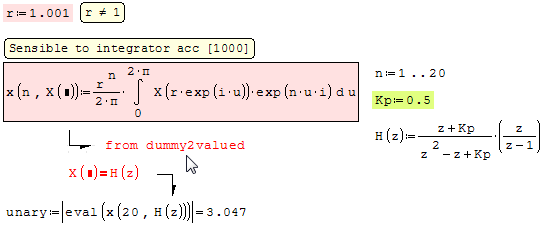

Dumb question maybe, but how do you get the '#' to show up in the H(#) function call?
#6 Опубликовано: 11.12.2018 00:50:47
As simple as that: x(n,X(▄)) ... simply the native dummy argument
big square imitation Alt220 ... try it.

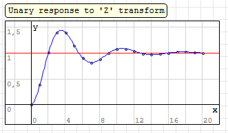

Thanks all you Doctors ! Just refreshing that huge collection
of PID examples, coming soon.

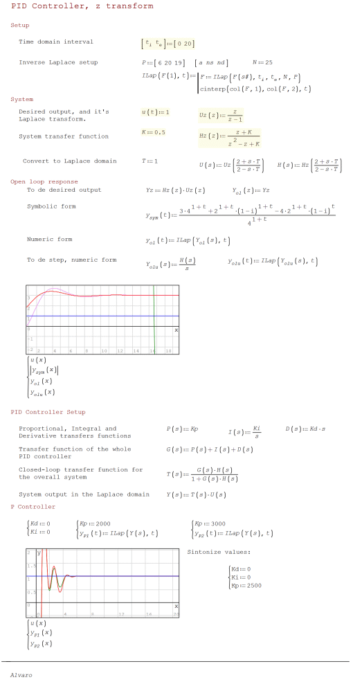

Hi. This is the setup for use inverse laplace transform for numerically evaluate the response for a system in z domain.
pid_controler z.sm (50 КиБ) скачан 1259 раз(а).
