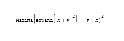

Dose anyone know why using the function expand of maxima dosent work? Thanks

Al usar el comando expand de maxima no ejecuta nada ejemplo

You have to use the functions correctly and you need to set optimization to None, otherwise SMath messes up the returned expression from Maxima.
Worksheet21.sm (3,74 КиБ) скачан 1458 раз(а).

GRACIAS
