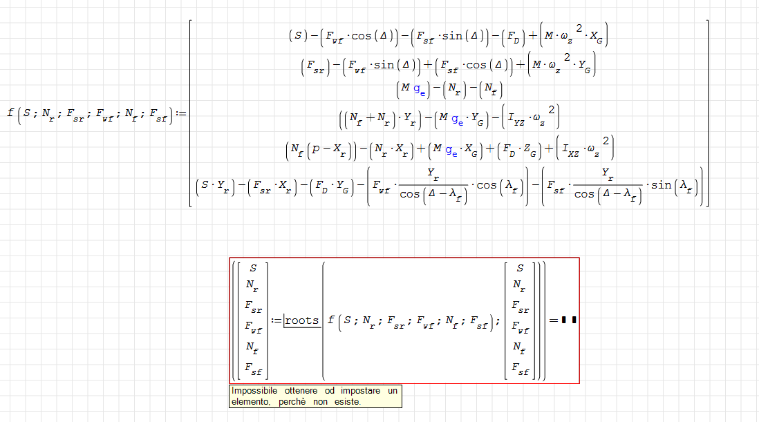

Hi to everyone
I am having difficulty solving a linear system like in the picture.
the error says:"impossible to get or set an item because it does not exist"
does anyone know where the error can be and how to solve this problem?
Thanks in advance

"roots" does not work with the units. You must adimensionare equations, or you can try the other features present in the plugin (eg "FindRoot" present "Nonlinear solvers" plugin)

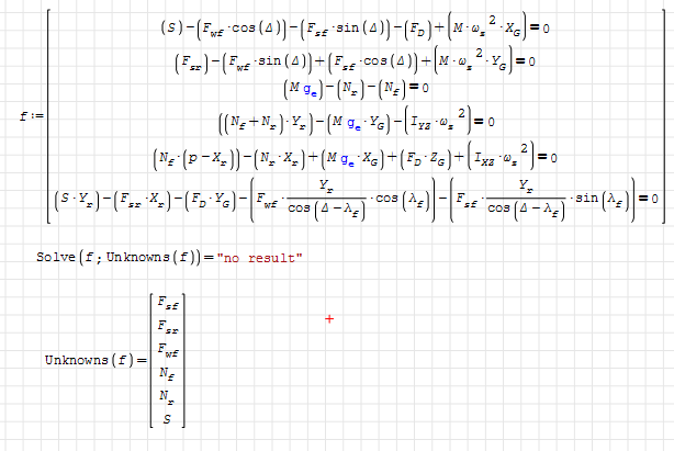

Equations 3 and 4 probably demand different values for N.r+N.f So there is no solution.
If the system has a solution, the function Solve() from Maxima plugin might find it.

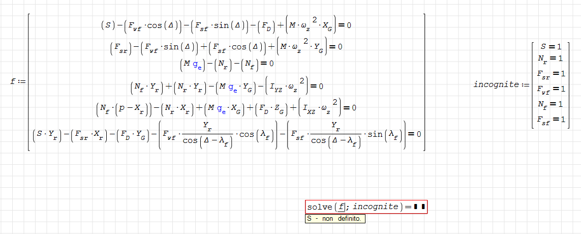

I tried to use the solve function but it still gives me an error saying that S is not defined
#9 Опубликовано: 06.11.2019 15:47:31
Did you read my reply just before your visit ?
sorry, when I wrote, I didn't notice your message
