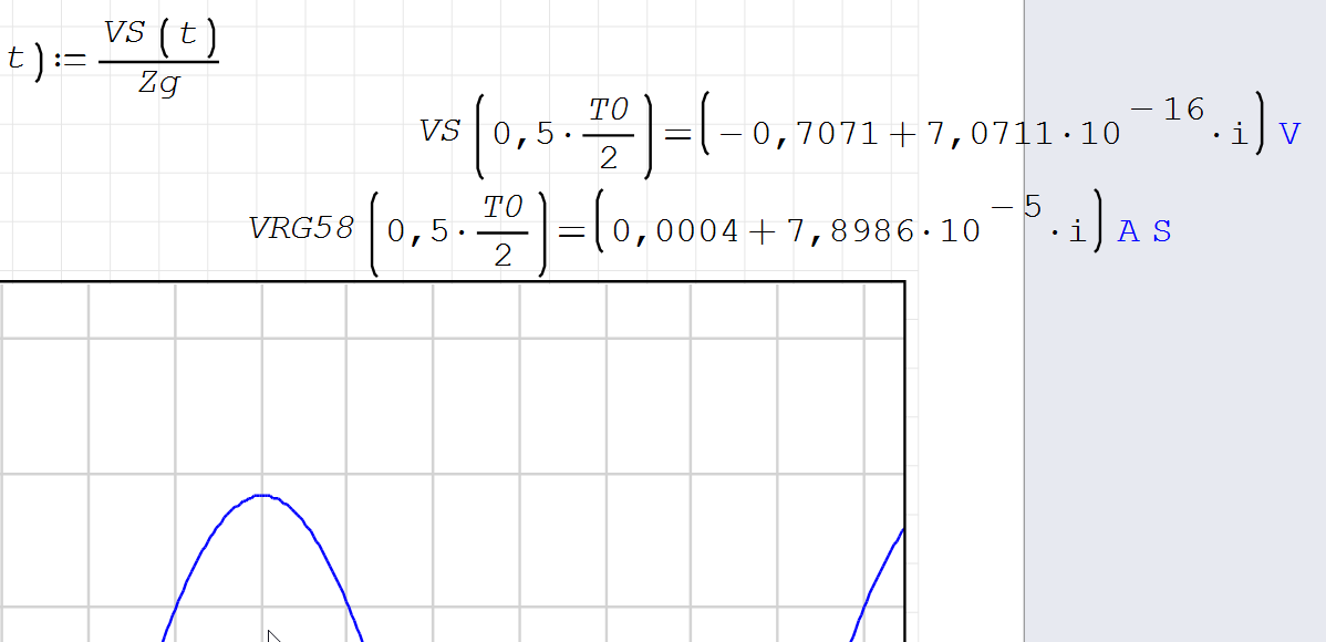

unfortunately, I can't find the error myself. Why VS(t) and VRG58(t) work well, but V1(t):=VS(t)-VRG58(t) not?
Regards Andreas

It seems that the two quantities have different units of measurement.

Thanks Sergio,
wrong was VRG58(t):=Ig(t)*(1/ZLRG58+1/RRG58)
right is VRG58(t):=Ig(t)*(ZLRG58+RRG58)
Regards Andreas

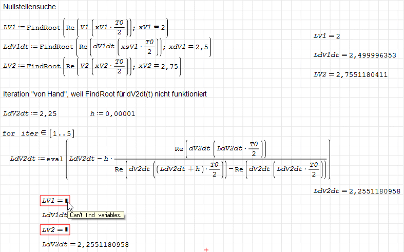

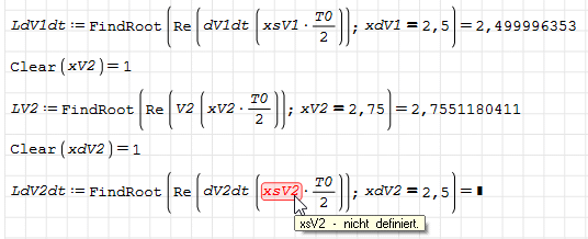

It's me again, with a new problem.
Why doesn't the last line work, when the four lines above it do?
Versuch mit R und C mit Oszi Auszug.gif Versuch mit R und C mit Oszi Auszug.pdf (910,43 КиБ) скачан 339 раз(а). Versuch mit R und C mit Oszi Auszug.sm (130,35 КиБ) скачан 493 раз(а).

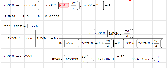

#8 Опубликовано: 13.05.2026 02:13:04
Hi. I have no idea why it fails, however this may be a workaround, consisting of directly applying the Newton-Raphson method.
Versuch mit R und C mit Oszi Auszug.sm (121,16 КиБ) скачан 482 раз(а).

And why can I only use the values for LV1 and LV2 once, but the values for LdV1dt and LdV2dt multiple times?
I had already deleted the `clear()` statements, but that wasn't the problem.
Отредактировано 13.05.2026 05:48:52
#10 Опубликовано: 13.05.2026 09:41:38
Hi. Use eval:
