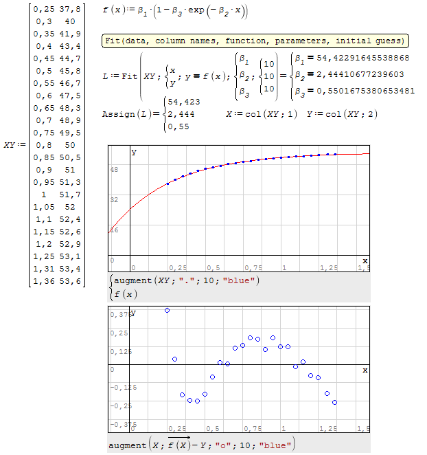

... here is the Genfit to this model.
Genfit Thermal Insulation.sm (33,25 КиБ) скачан 1287 раз(а).
Demo for usage of the Fit() function (Maxima)
Genfit%20Thermal%20Insulation_Kr.sm (9,13 КиБ) скачан 1402 раз(а).
