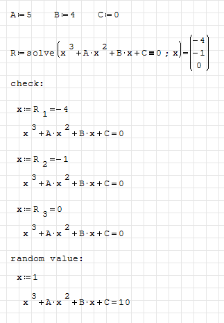

No issues here

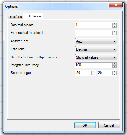

#32 Опубликовано: 16.04.2015 18:20:16
I see... BTW also the cloud version gives 3 roots
Yuo can try to check if something is different in the global settings (Tools > Options... > Calculation)

Now is working. I changed Roots (range).
Thank you for your help

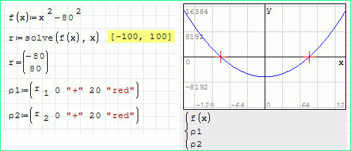

Here are your two plots c/w the roots shown on graph.
I have used the 'Solve Quick' in separate sheets not
to confuse solve[f(x),x] with the two differents
search range. Handling graphs are very easy, just a
matter of adjusting each direction [X,Y] separately.
Your solve with bracketed search range is perfect too !

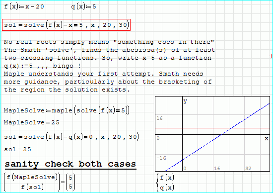

Collab,
Your turmoil is solved. Always plot before you attempt more maths.
