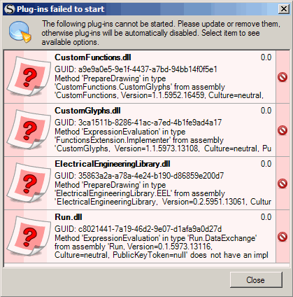

Like expected, some plugins are not active, fine...

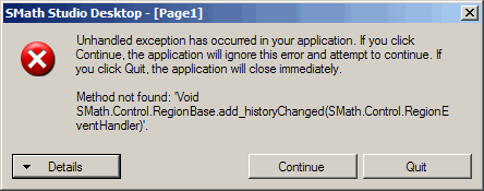

... click "close" to open 5935, it opens. I can see the slider, the numeric up/down
is not there and so on. From the f(x), "Dot Numeric is there, fft, NOT mwxxx, not "cases"
and so on. open smath 5346 work shets NONE[ read NONE] of the 5346 open.
Just this mystic message

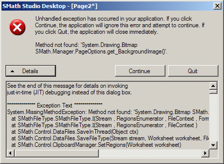

Whatever else, I get more mystic messages

The correct way to update is:
Download install latest MSI overwriting current installation (in you case, since since you were doing some manual stuff, completely uninstall SMath and remove folder in user/appdata).
Once the latest version is installed open it up. Go to plugins - > online gallery (include beta versions). Update all plugins highlighted purple.
You are good to go.
Anyway if you do NOTHING by hand (unzipping / pasting) you are very likely to encounter ZERO problems.
And remember, in Soviet Russia you do not mess with software, the software messes with you!
P.S.: I apologize for crude humor, hope no one got too offended here.

Wrong. Settings and extensions (plugins, snippets, workbooks, ...) are stored for each Windows account in the %APPDATA%\smath directory. When you update or you install another version you inherit all the extensions from that path.
This means that you cannot install 2 different versions for the same account, because they share this folder, and plugins made for a version often are not compatible with the second (and vice-versa), thus one or both the executables will fall in troubles.
In theory I guess it is possible to have 2 versions for two users, if you install every version "only for me" when prompted at the begin of the installer (never tested).
The only way to have more than a version for the same account, is to use a portable version, that stands in his bubble soap.
Then donwloaded all plugins, open/unzip,
copy all dll's, pasted in 5935 plugins folder.
Not sure what you did here, but take into account that if you have a plugin in the installer plugins directory (C:\programs...\SMath Studio\plugins) and the same plugin downloaded via extensions manager (%APPDATA%\smath\extensions\plugins), the extensions manager version will be used; also, the Extensions Manager will no show you updates for that plugin. This folder is intended just for built-in plugins and for developers (for fast testing).
In short:
  • Have only one version for the installer
  • Do not put dlls in the executable path or his plugins folder

Hey, sorry to hear your troubles... I am very hopeful we can get you working with the latest stable 0.98.5935.
When you are in trouble it is always best to:
1. Completely remove Smath from Control Panel / programs nd features, delete C:\Program Files (x86)\SMath Studio and C:\Users\USER\AppData\Roaming\SMath. This will COMPLETELY erase any trace of SMath Studio on your machine. Also delete / unplug portable install as well, just to be sure.
2. For certainty, search & extreminate for anything that includes SMath in the name in your file system (never had to do this myself). Also search the registry? Again never did that. Now you are back to step one (where you would like to be).
3. Download and install latest stable from here http://en.smath.info/forum/yaf_postst7417_Stable--SMath-Studio-0-98-5935--01-April-2016.aspx
I have installed SMath on many machines from XP to Win 10 and those two steps never failed me when things went sour. SMath install should not be this painful; never was for me on all 4 PCs. I feel for you.
Also in future, if you upgrade to a newer version by running updated MSI, on first start go to plugins - > online gallery - > include beta and update all purple colored plugins. If this is not done you may encounter errors.
