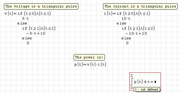

Any idea why the integral is not evaluated?
Thank you,
Basile

Hello Basile,
I remember I mentioned that few years ago - see this link please int() does not like if. Try your own integration function like this one presented in the Examples section on the Wiki Gauss-Legendre integration
Maybe some motivated plugin maker will take this into consideration

Do not use "if" and attention to the use of "<=" and ">="
