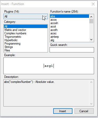

go to insert > functions... and play with the plugins dropdown to see what functions are carried by each plugin, also by Special Functions
#5 Опубликовано: 20.03.2019 21:42:25
dio pants
dio pants
16 сообщений из 180 понравились пользователям.
Kinda like this.....
