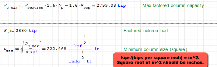

I've been using SMath for several years, but have always had to use it set to Metric for default units even though I work in the US with Imperial units. It's never worked as expected with Imperial units, so for every worksheet I write, I manually convert every single entry from meters to inches, megapascals to ksi, etc. I tried setting it to Imperial units as a default again to see if it worked any better now. But as you can see below, it still has some issues. The formula below works fine when set to metric, but not, ironically, to Imperial. I've had similar issues in the past every time I tried using Imperial. Are there any workarounds or ways to fix this going forward? I normally just deal with the manual line by line conversion, but the "Ceil" function that I want to use on the resulting decimal column size didn't work even with it set to metric (it just rounded 26.453 inches up to 1m, or 39.37 inches, instead of the correct 27 inches), so my typical approach of using Metric doesn't work here either. Any ideas (or a fix) to make Imperial units work correctly would be much appreciated.

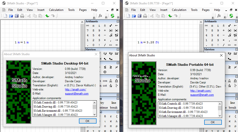

You can make any version of SM portable by adding blank text file to the same folder as the exe, then change the text file to system file with name "portable" and extension "version" (portable.version)
Here is a snip of a fixed install running side by side with a portable install. The portable install will only reference the files and setting in the root folder of the install. So in Theory, the portable version could be the US units version and the fixed, the default metric.

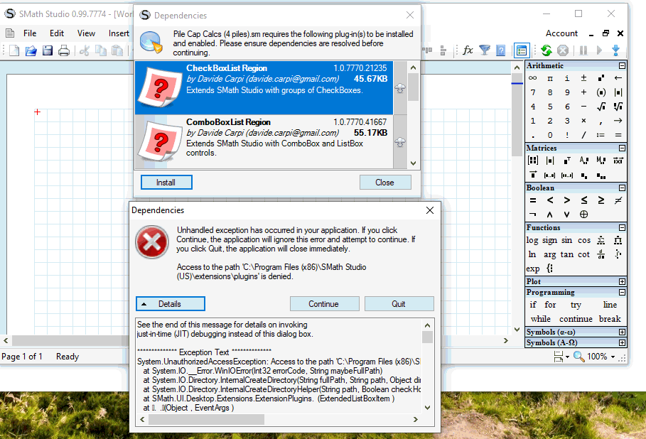

That's cool. I've heard the term "portable" thrown around on these forums before, but didn't know what that signified. Adding the portable.version file worked, but then I get the following error when trying to install a plugin. Any ideas on how to proceed? Deleting the portable.version file allows the program to work as expected with all plugins recognized.

Although I can copy the currently installed version to an "SMath Studio (US) directory and add the portable.version file to that directory and confirm one is standard and the other portable, it may not help if I can't get the plugins that are used in the worksheet to be recognized on the portable version. Something to do with Windows permissions, maybe?

Well, that's the thing. If I delete the portable.version file out of that 2nd install directory, then everything works and there are no plugins to install. They're already loaded, and in fact, I'm already signed in. I'm directly opening the exe file in the 2nd install directory, but I would almost think it was using the program exe from the standard install the way everything comes up, except for the fact that it opens the worksheet built on the US units.xml file correctly, so I know it's in that 2nd install directory. Is there another place that the plugins are tracked or stored? Because both install directories have identical plugins folders, and neither is anywhere near all of the plugins I've installed.

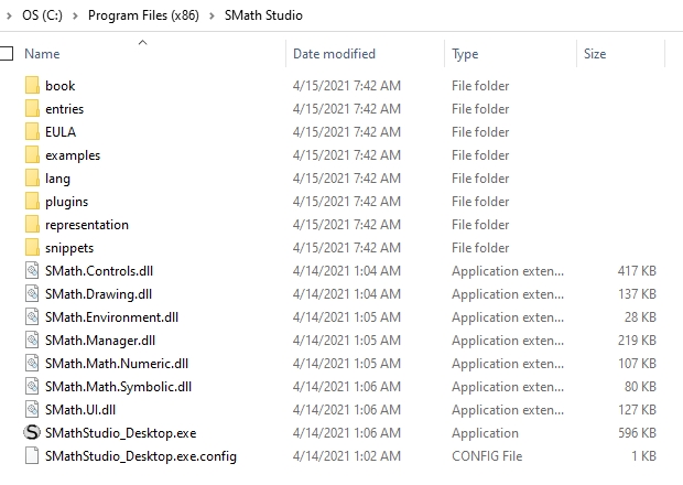

Extensions folder? I don't have that on either install... Is that in your Program Files (x86) directory? I don't see any other directories under Program Data or elsewhere that it could be, but then stuff seems to get hidden everywhere these days.

Okay, I just did a simple test. I copied my current install folder containing my smath installation with all the extensions/plugins in place. I converted the copy to a portable version. I then changed the units.xml file in the portable version. Then I opened each version by clicking on each versions exe file. Both seem to work just fine and contain the same extensions.
Clicking directly on .sm files will prompt the regular installation, so to open with the portable version, you need t first open the portable version through its exe, then open the file you want to work on through the open file in the tool bar.
There is no need to install again, just simply copy the current install. I have it installed on a second SSD that is not the C drive, but if you have it on the C drive, I think having it in C:\Users\"your username"\AppData\Local\Programs seems like a good place.
