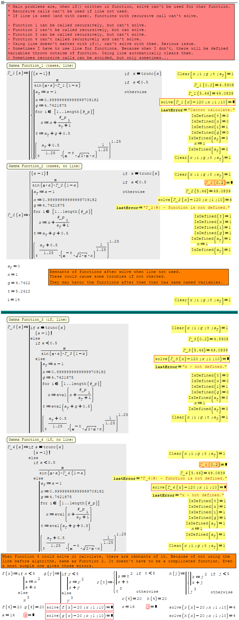

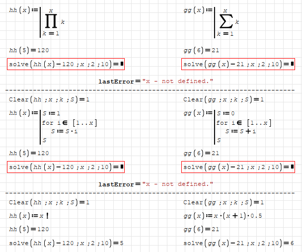

I have diagnosed the symptoms with solve bug.
Made a page about this and tried to explain with detail.

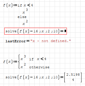

Wrotesolve(), roots(), FindRoot() doesn't like if statement.
However, they can solve when cases() used instead of if().
if/else was reported SS 5346.
Davide added if/otherwise SS 6179

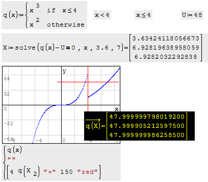

Often, the solve bloc is ~ exact, sometimes exact
At worst 4/5 decimals.
Always start true Bolean #≤# ...
often won't complain incomplete #<#
From recollection, only DeBoor needs incomplete.
WroteUpdate of statement:

IMHO, its logical solving piece wise discontinuous,
solve piece wise as well for productive classroom.
