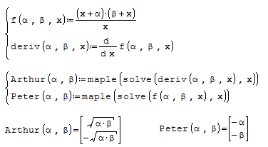

Here's something I put together. You'll need the Maxima plugin to run it. SMaths built in symbolic engine is lacking and therefore it's generally better to use Maxima or maple plugins when solving symbolically.

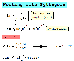

Circle Pythagora.sm (5,76 КиБ) скачан 1138 раз(а).
