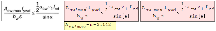

As an engineer I use the Eurocodes all the time. In Smath I always use the underscore "_" instead of the comma "," for the definition of variables, as shown above in the post of Jean:
Asw,max → Asw_max
because it is the easiest / fastest way of typing, without the risk of making fault formulas.
And I had never any complaints from anyone who checked or commented to my calculation reports for this way of typing.
Regards, csb
Asw,max → Asw_max
Regards, csb

WroteAsw,max â Asw_max
... just a bit pest in numerator vs apostrophe.
