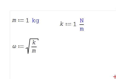

For a simple harmonic oscillator with mass "m" (kg) and spring constant "k" (N/m), the angular frequency of oscillation is sqrt(k/m).
If we used the SI units, the angular frequency unit should be (rad/s) but when I use units in SMath it gives the answer in Hz..
So, is there a way that I can correct the units for an answer? Thanks in advance

You can change units in this way...

... Unit User Hz ... rad_s.sm (2,82 КиБ) скачан 1403 раз(а).
