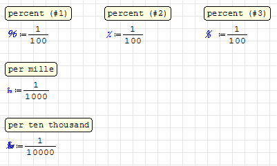

#1 Опубликовано: 30.06.2013 12:16:01
An old personal snippet, revisited.
snippet shortcut: percent
Best regards,
Davide

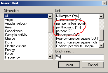

#2 Опубликовано: 30.06.2013 14:21:41
Simply great! I tried that and did not find appropriate characters.
If you want to have these units built-in, then replace the file units.xml in subdirectory "entries" of your smath installation.

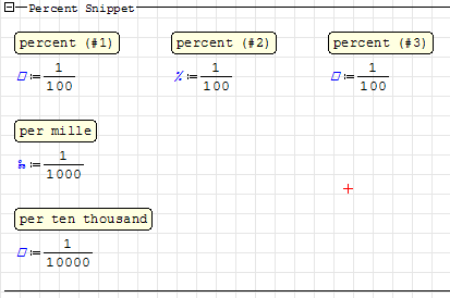

#3 Опубликовано: 02.07.2013 07:43:06
kilele
kilele
@Davide
Some of the unicode symbols don't show up correctly in my installation (mkraska portable version). See picture.

#4 Опубликовано: 02.07.2013 08:10:15
Seem that your "courier new" font is not updated...
Try looking here and here (with the same machine) if you have the same issue.
