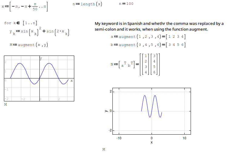

I installed Smath Studio from the AUR repository, I am using Arch and the installation went fine.
I am reading the document GraficasBasicas2012.pdf, which I downloaded from the Wiki Tutorials.
The problem is that the function augment(1,2,3) works different under Linux, and I cannot figure out how to make a simple graphic as the one in the adjointed file.
graficos_prueba.sm (9,46 КиБ) скачан 1608 раз(а).
Maybe someone could help me, regards.
#2 Опубликовано: 29.03.2023 15:59:11
Javier Ochoa
Javier Ochoa
3 сообщений из 26 понравились пользователям.
In the Tools->Options Section I could change the semicolon <;> and now I use the comma (,) as separator. Now I can use the function augment with comma (,) but the graphic function is still not working.
I wonder whether someone can give me a hint.

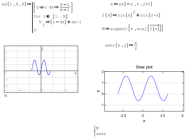

#3 Опубликовано: 30.03.2023 08:09:11
... fast, perfect meshing 'x'.
#4 Опубликовано: 30.03.2023 10:21:48
Javier Ochoa
Javier Ochoa
Hi Jean,
Tank you for the post, he problem was solved using the pallete. I will mark as solved.
#5 Опубликовано: 30.03.2023 11:34:39
Hi Jean,
Tank you for the post, he problem was solved using the palette.
NO Javier, NOT solved.
Your 'x' is improperly meshed.
#6 Опубликовано: 30.03.2023 12:16:30
Javier Ochoa
Javier Ochoa
Hi Jean,
I can reproduce your example without any problem, I cannot understand where the parameters H,N and L are defined. Also, you defined a function xd and used to evaluate x. Why I cannot use range?.
I suppose that is there an useful explanation for this, which I am curious about it. Maybe, you can give me some hint?
#7 Опубликовано: 30.03.2023 13:09:12
Hi Jean,
[L,H,N] are defined in x:= xd(L,H,N)
Why I cannot use range ?.
If you use range, 'x' will start -pi
but will never exactly terminate +pi
unless N in range is 15 decimals ... totally foolish.
Your graph does not terminate +pi.
xd discretizer will populate exactly any 'N' ± pi.
Cheers ... Jean.

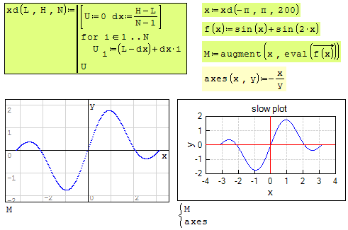

#8 Опубликовано: 30.03.2023 15:28:21
... complete algo style, one of my preferred.
Javier.sm (10,69 КиБ) скачан 1597 раз(а).

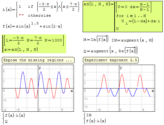

#12 Опубликовано: 31.03.2023 10:55:57
Hi Jean,
I am greatly surprised with your answer.
I will take care of this lesson in future calculations.
Thanks in advance,
The all thing is to complete a project, mostly export.
See the missing regions ...
Please, don't hesitate ... Jean.
Javier More.sm (9,5 КиБ) скачан 1642 раз(а).
