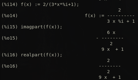

Natively, I don't know how it can be done.
Possibly you can't because smath symbolic engine is inferior.
Maxima can solve it. I assume maxima plugin can solve too in smath.
Maple plugin couldn't solve, maybe there is a trick I don't know.

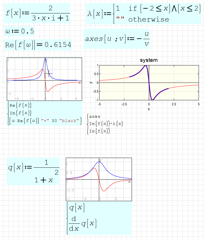

As suggested ... remembering Imaginary is the Derivative
Worksheet104.sm (9,66 КиБ) скачан 1608 раз(а). ... Please, let me know if working ... Jean
If anything you posted is related with question,
If any of your replies contains tiny bit fraction of correct answer,
It would be a miracle.
NO, IT IS NOT WORKING BECAUSE IT IS JUST A PLOT.
This is what Jean posted!!!

Maybe, Re() and Im() are worth adding to MaximaTakeover? Yet wrapping in Maxima() does the trick for now.
ReIm.sm (3,95 КиБ) скачан 1566 раз(а).
