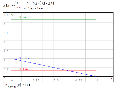

I have found a low priority issue where special plots (e.g. text shown on the 2D plot) do not appear on the 2D plot when using an "if...else" domain definition. The Special Plots do show up if I use boolean domain definitions, however.
I have attached a sample file here that should make it clear.

If you declare the system is exact Bolean,
set it exact from the onset plot 1

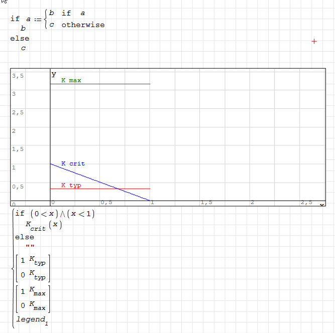

You can use cases() in Custom Functions Plugin for that purpose.
Plotting, solve(), roots(), FindRoot() and various commands may don't like if/else.
Sometimes an error can be fixed by using a line(), not in your example though.
Recursive functions doesn't solve when line() and cases() used both, etc etc.
These are bitter tricks/bugs, I tend to forgot them everytime.
After struggling a while however I remember the "correct usage".
#4 Опубликовано: 21.03.2022 18:30:37
Would be interesting, why if() is not defined by default as boolean expression just like cases().
Is there any use case, where the original if() is better than the one defined with cases()? If not, then I propose to include re-definition of if() in the custom functions plugin.

Bolean bug(s) are user bug.
Many projects will accommodate either style if/else ... if/otherwise
A long suite of conditions is horror if/else.
Doctor your plot 1 as proposed, press F9
Hi Martin. Yes. Here one: https://en.smath.com/forum/yaf_postsm34552_Custom-Functions-plugin.aspx#post34552
and here the Davide answer about that: https://en.smath.com/forum/yaf_postsm34559_Custom-Functions-plugin.aspx#post34559
I also remember some other about what complex could be the expressions in cases(), but can't found that.

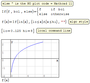

#9 Опубликовано: 22.03.2022 11:42:00
... you make Bolean algo style
for convenient command line.
